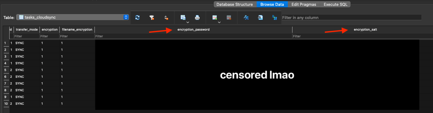

I found this in /data/freenas-v1.db:
Your are right. The password and salt are stored here.
I think there is no way to prevent stealers to recover my encryption password and salt, a way like the prompt to unlock dataset/pool.

By the way, "censored lmao" is a weak passphrase. I highly recommend you change it to something cryptographically stronger.
This is not my passphrase. I will never send any hint of my true passphrase.

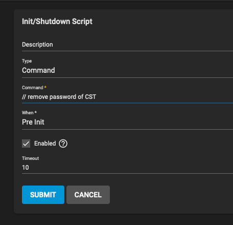

Do you think there is a way to remove all password at each restart with "Init/Shutdown Script" ?
If possible, any link to help me to use the TrueNAS API ?
Oct 22, 2019
3,641
Way out of my wheelhouse. That might even result with unforeseen problems, since the middleware isn't expecting a Cloud Sync Task to have its salt or passphrase removed from under its feet by an external script.
