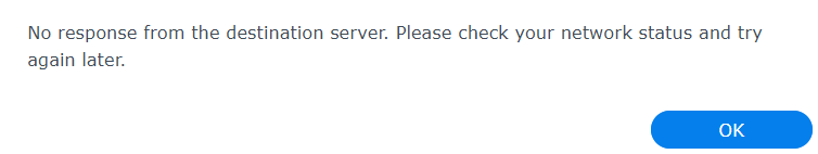

I just tried this, but it failed on the Synology with "No response from the destination server. Please check your network status an try again later."
I have double checked the TrueNAS IP entered, but it is correct?
Any idea what could be wrong?

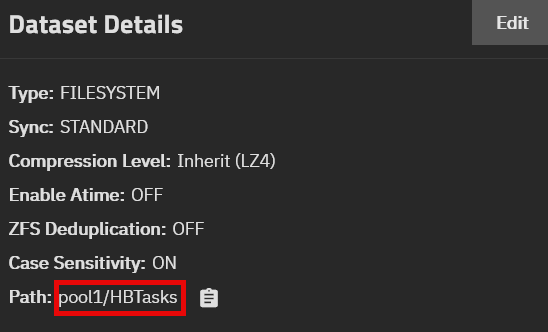

jst68
Oct 28, 2023

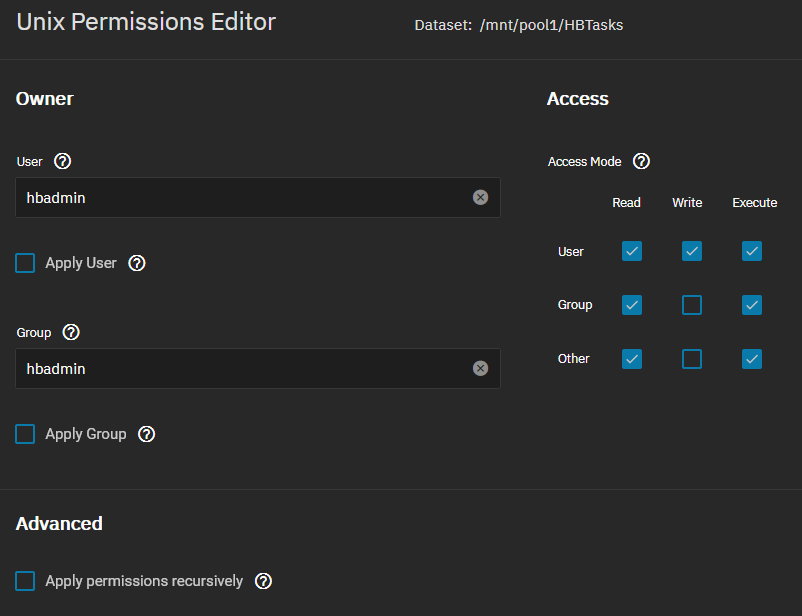

Here is my hyper backup share on TrueNAS.

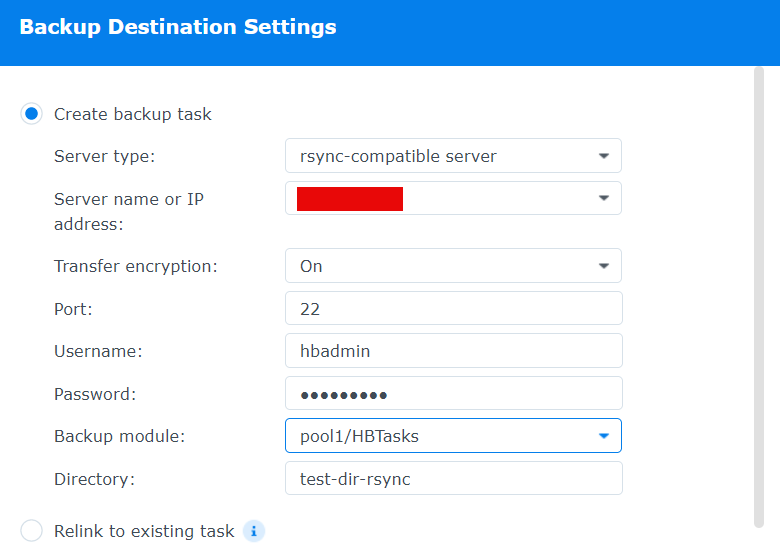

And Hyper Backup on Synology.

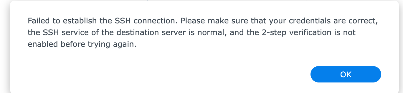

Once I press "Next", it fails with the following error.
Any help is appreciated. I have already double checked the IP. Firewall on Synology is off.

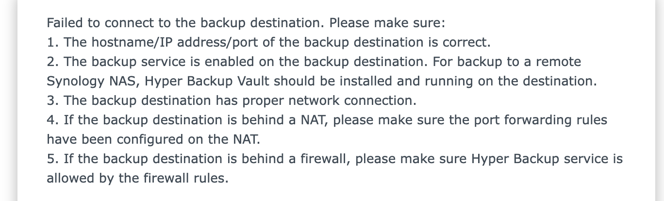

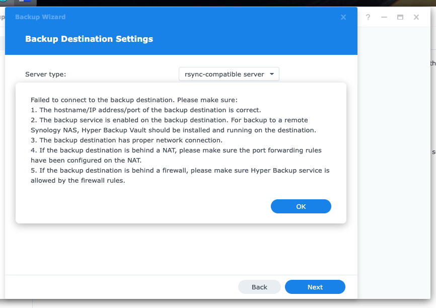

yes. I also have the same problem @jst68 has.
not able to connect to the host.
I tried to ssh from synology to truenas to see if the truenas is reachable from synology. And it is reachable.
however, somehow, synology kept showing this error msg.

well. nvm. I forgot to set the block module by myself.
