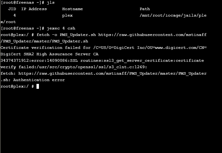

pkg install ca_root_nss and try again.

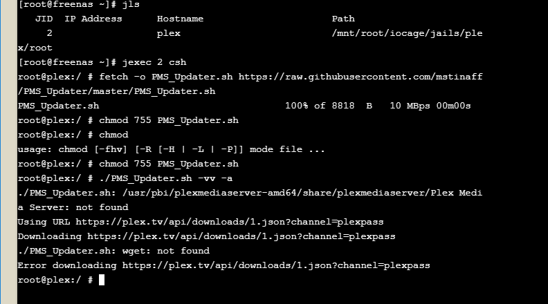

so that fix it and now I'm getting an error when i run this command: ./PMS_Updater.sh -vv -a and I'm not sure if this command is even working: chmod 755 PMS_Updater.sh.

gt2416
Feb 4, 2018
262

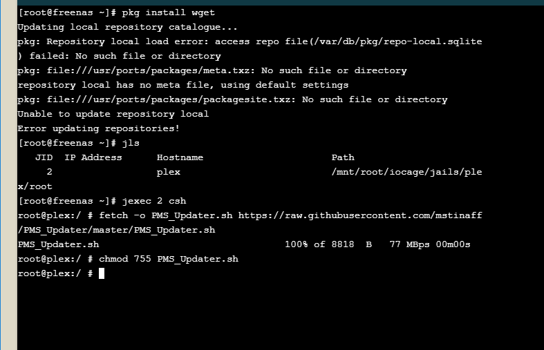

pkg install wget and try again

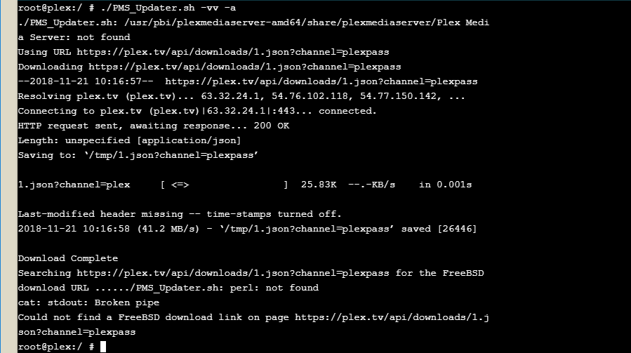

that work but it now saying it can not find freeBSD download link and I'm still not sure if the chmod 755 PMS_Updater.sh is working still.
15,504
I don't know why you're wondering this--if it isn't giving an error, it's working. And if you're able to run the script at all, the permissions are set correctly.
As to the update itself, why the pathological desire to have Plex so up to date? For a standard jail, use pkg upgrade. For a plugin, wait for the plugin to be updated and upgrade then.
