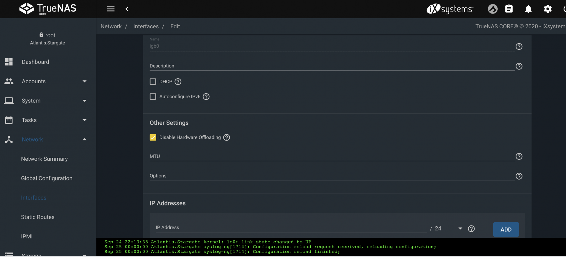

So I just checked "Disable Hardware Offloading" for the physical interface and now the network throughput is back to normal. Never had to do that on 11.3, not sure if this will cause issues.
Can you post a screenshot where to find this setting?
raidflex
Mar 14, 2012
531

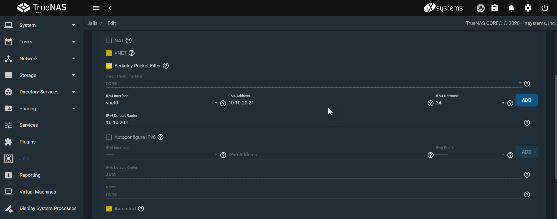

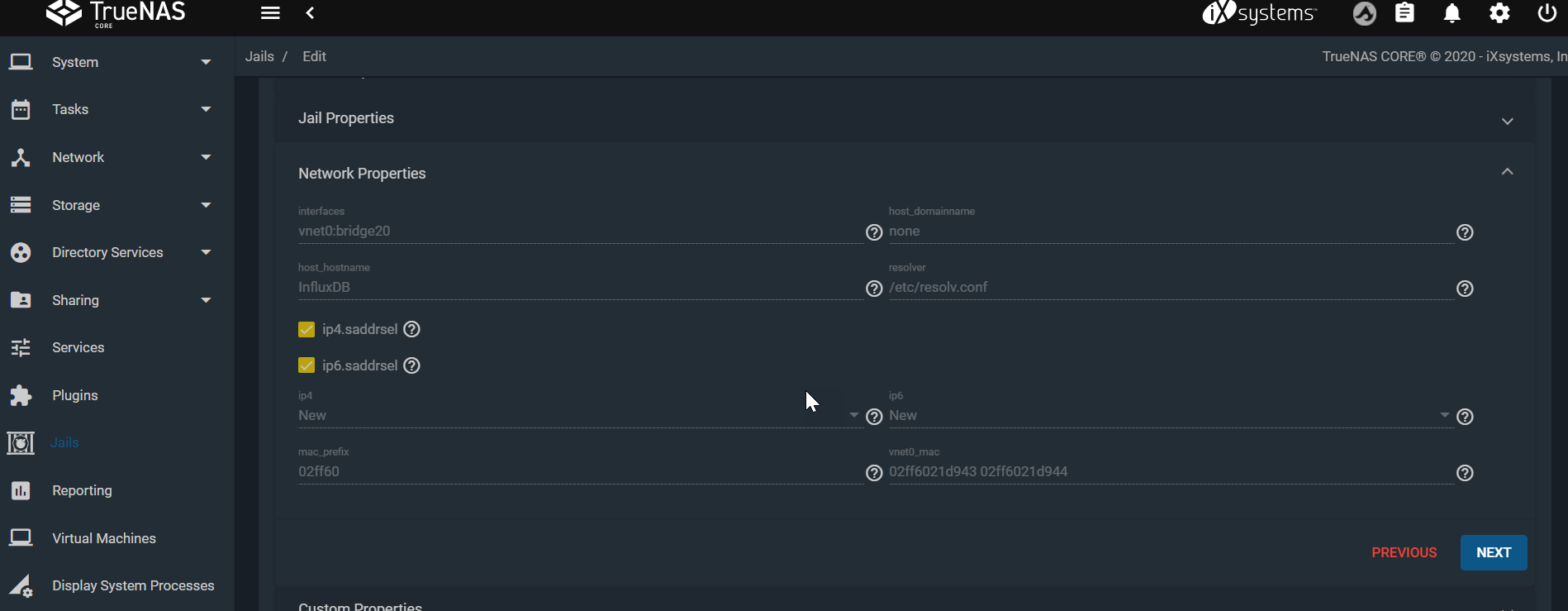

What is the default gateway's address for the jails in VLAN 20 and which device is it?
raidflex
Mar 14, 2012
531
Patrick M. Hausen
Nov 25, 2013
7,776
Which device has got an IP address of 10.10.20.1? And is that device capable of routing?
raidflex
Mar 14, 2012
531
That is default gateway set by my pfsense firewall for VLAN20.
The pfsense firewall handles the VLANs, my Cisco switch is just setup as Layer 2.
