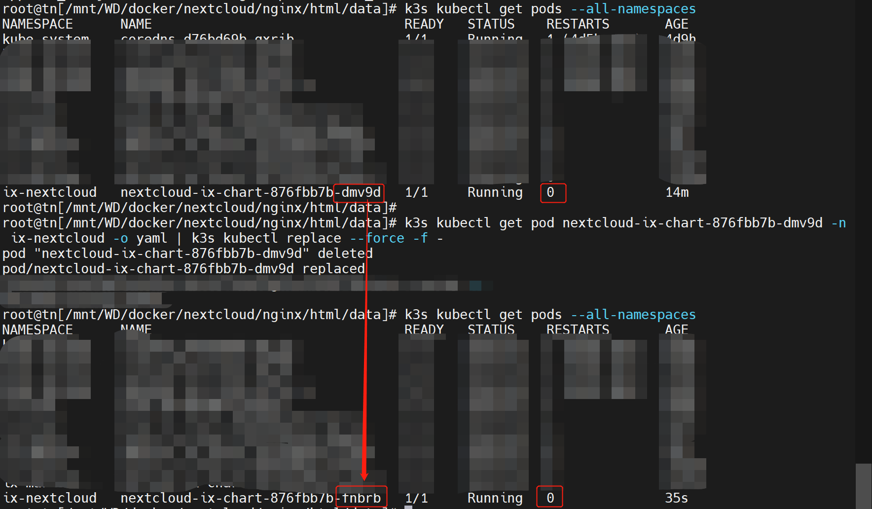

How to restart application rather than stop and recreate a new one?
I tried:
k3s kubectl get pod {podname} -n {namespace} -o yaml | kubectl replace --force -f -
But not working, it returns:
zsh: command not found: kubectl
Samuel Tai
Apr 24, 2020
5,399
You forgot to prepend k3s in the 2nd invocation of kubectl.
newbacai
May 21, 2022
11
Thanks so much. But I found that the system still remove and build a new one:
Is any possbile to keep the same pod?
