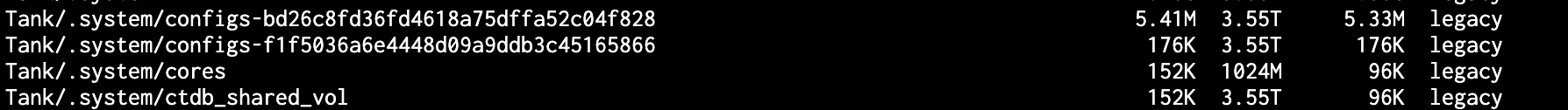

Thanks all, so there is hope after all! I took a look and found the file that you mentioned. I'm just not sure what to do with it at this point.
Here's the screenshot of the files that I found:

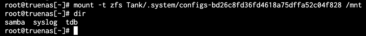

I picked the first one because it had the larger file size, and then when I ran the code you sent. Here's what I've got.
Any help on where to go from here would be great.

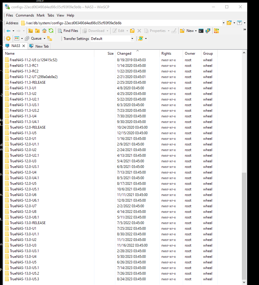

You need to open that file to get at its contents. Here I use winscp to open mine:
The above is the bottom of the listing of the files in it.
Find the most current version and open it:
here you can see the automagic 03h45 saves for -U5.3
Pick the config file of the date you want to use and copy it to /data with the filename freenas-v1.db

Thanks so much for this @Redcoat . I've gotten WinSCP working, and connected as root. I used the same path as you but that just took me to the config files from the fresh install. In order to get to the one stored on the disk I somehow need to find Tank/.system/configs-bd26c8fd36fd4618a75dffa52c04f828
As close as I can figure the path I want is "mnt/Tank/.system/etc.", but I can't see .system anywhere in the directory. I'm guessing it's hidden, but I enabled show hidden files with no luck.

Its quite possible that there's a new unique identifier dataset name for the relevant children datasets.
You can confirm with this, which will clue you into which child dataset to (temporarily) mount.
zfs list -t filesystem -r -o name Tank/.system
You might see "duplicate" datasets listed, with a different appended unique string.
You can compare it to this output, which will show you the currently mounted datasets. My hunch is that the currently mounted ones are irrelevant to the config file you wish to extract. Which means you'll have to temporarily mount the "older" one:
zfs mount | grep -F .system
You won't be able to access its contents, even with WinSCP, if it's not mounted in TrueNAS. So you need to manually mount it first, as TrueNAS's middleware will not do this automatically if it's using a different (newer) dataset to house your "config-XXXX" contents.

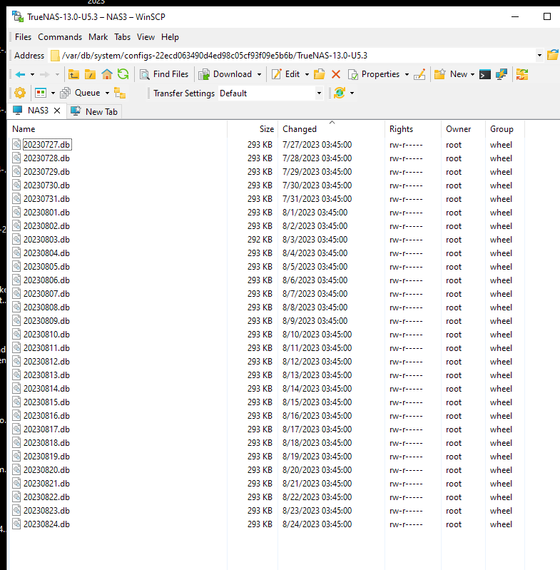

Step 7 - Navigate to /mnt and you should see two folders, one being the current version of scale you are running, and the other being the older version that you were using when your boot drive died. Pick the older one.
Step 8 - Feast your eyes on all the delightful backed up config files that TrueNAS quietly made because it knew one day it would have to save you from yourself.
Step 9 - Download the most recent one ( for me it was at the bottom) to your computer (not the one running TrueNAS, that would be silly, the one you are using to run winSCP
