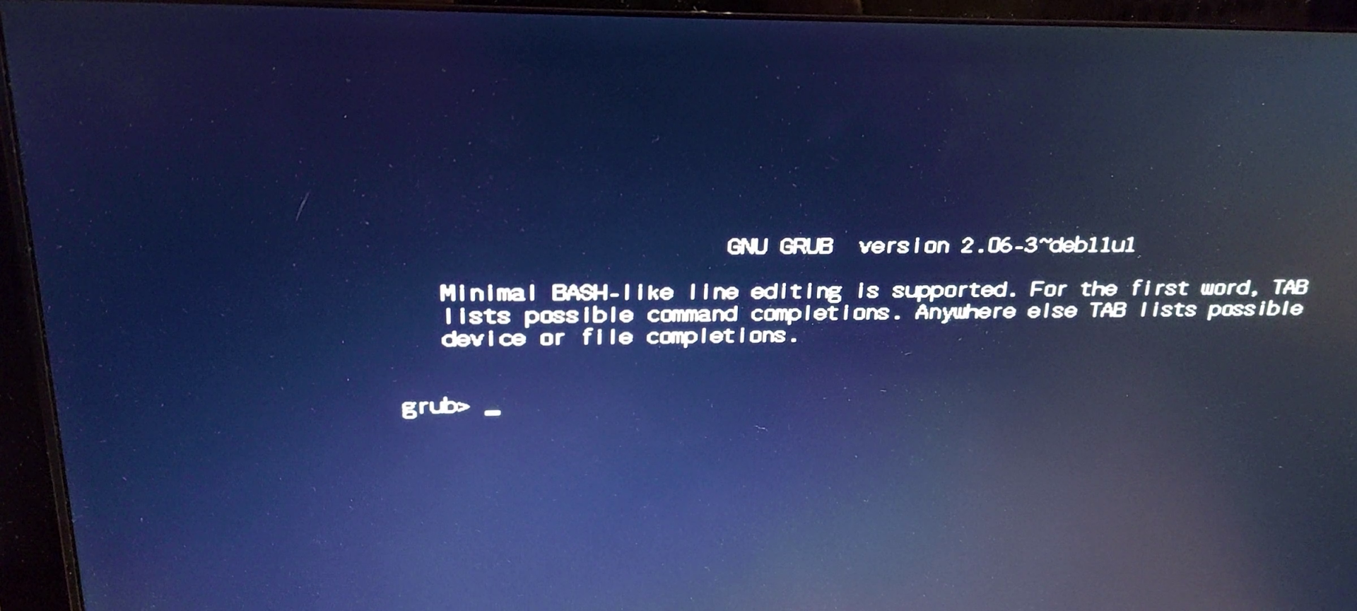

Hi everyone,
My bootpool broke after replacing one of my SSD's (see my other post in the hardware forum), i can't boot anymore. It's stuck at Grub (not the rescue variant).
And you've guessed it: I don't have a backup of my config file.
I believe all the data on the drive should be there, so i'm wondering if it's possible to connect the drive to a Windows PC to copy the config file so i can reinstall my TrueNas?
Another question i have: If i do a re-install without the config backup, is my data pool still availble? Can it be imported or something? I don't think my pools were encypted.
Hope that someone can help me out, cause i'm in panic mode for last couple of days :(

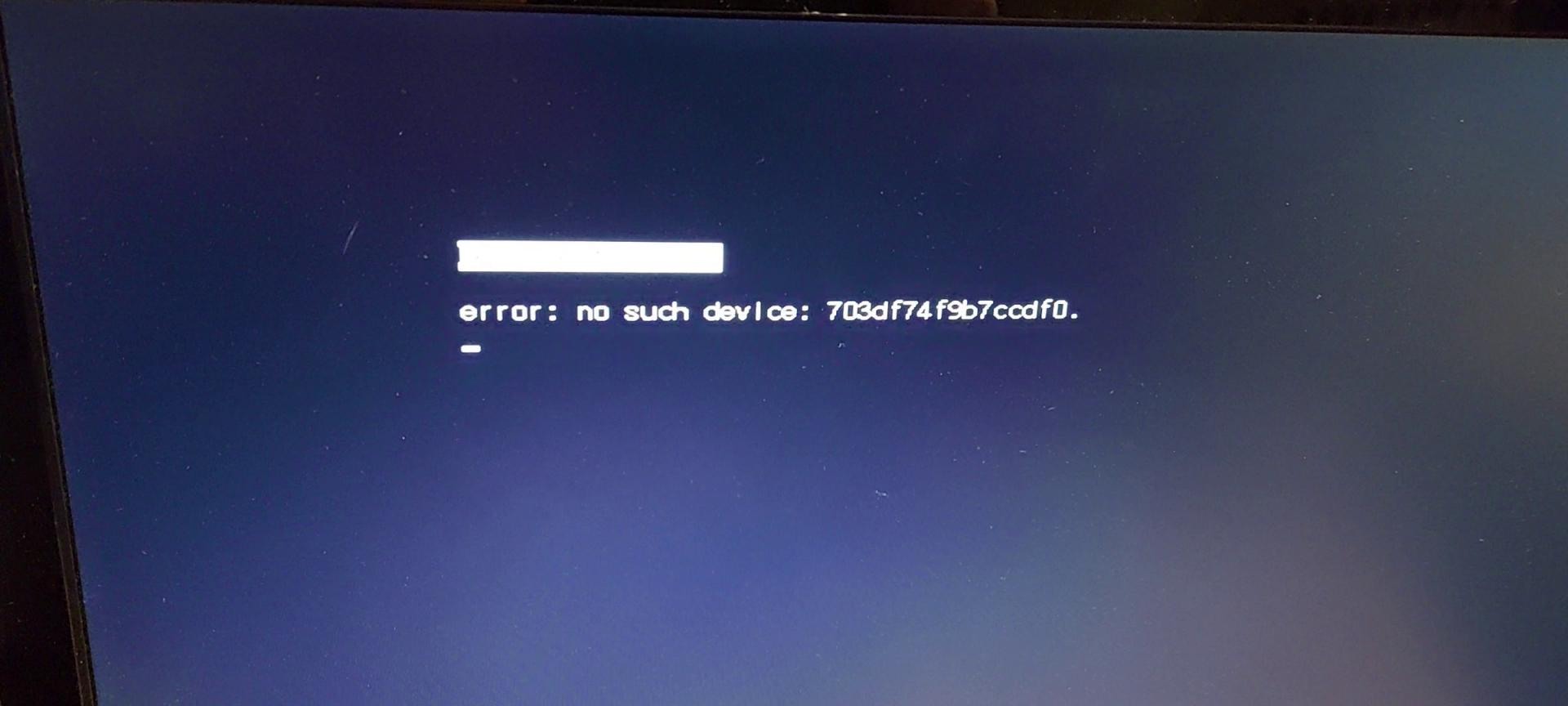

To clarify, the boot of Truenas give this error and then boots into grub after replacing a broken boot ssd. It looks to me like a grub config error, but i don't have the knowledge to fix this and couldn't find anything on the internet other than re-install Truenas with a back-up config.
Thanks for all the responses so far ;)

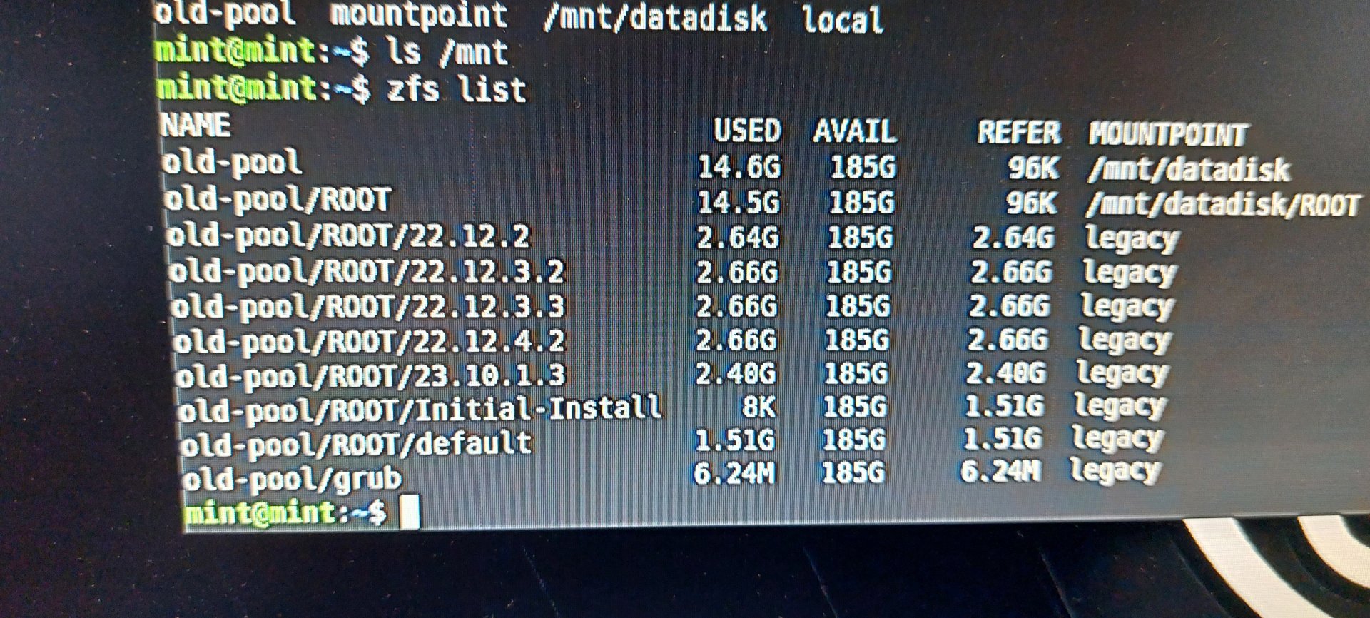

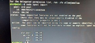

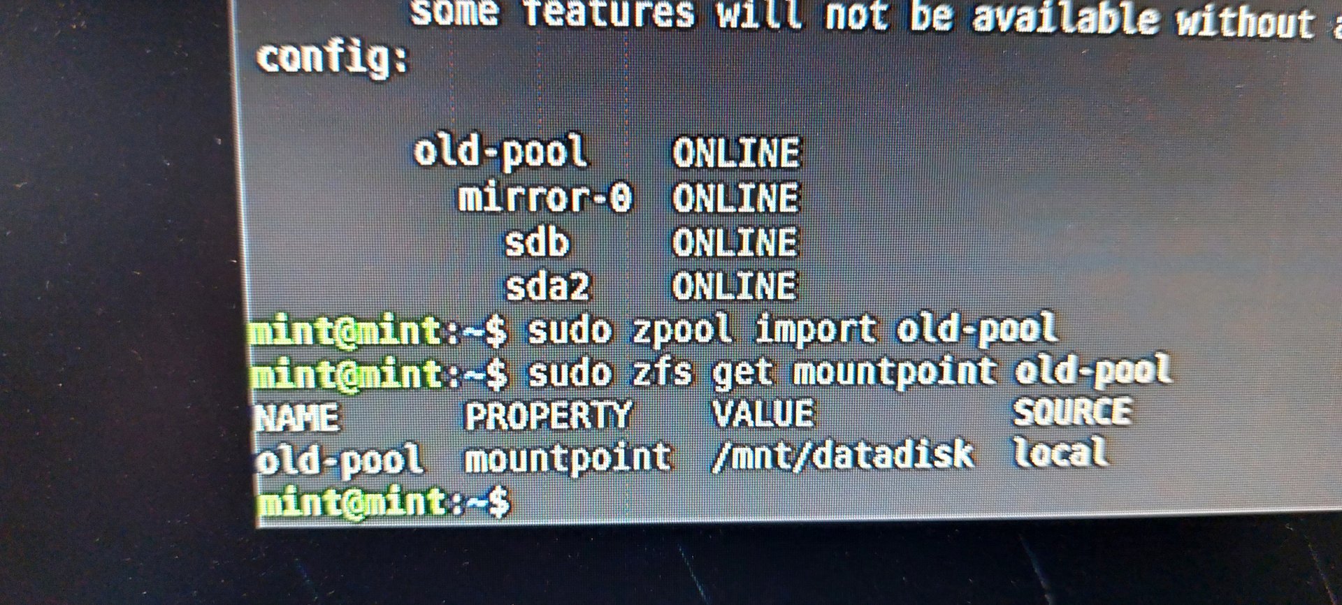

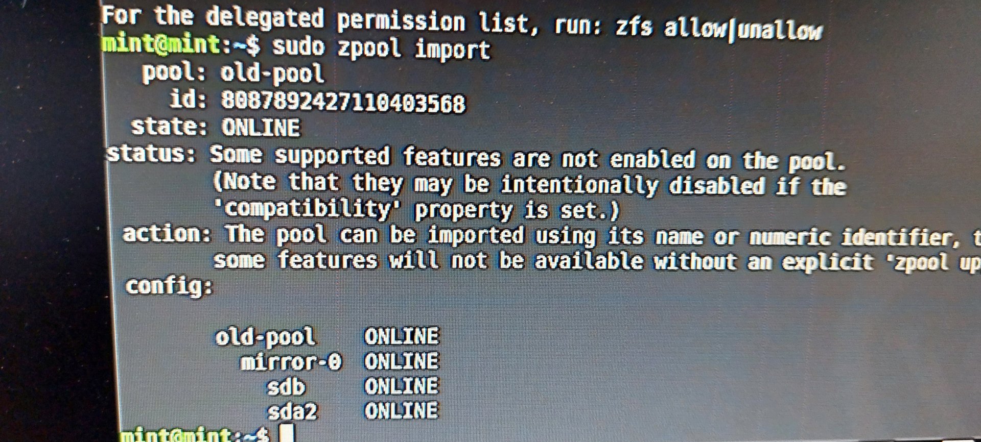

So i actually got somewhere, but don't know how to proceed. I used Linux Mint (supports ZFS).
I renamed the boot-pool to old-pool and can import it with no error. In the second picture i checked the mountpoint, but don't know how to mount it. I've tried different different mount options (mount -t zfs and zfs mount), but getting errors like can't find old-pool/ROOT/default in /etc/fstab or cannot mount legacy mountpoint.
And what item do i mount from this list? :)
Thanks again for the help!

sfatula
Jul 5, 2022
608
do man zfs-mount for how to mount, you'll need the directory to exist on the system you are trying to mount on. I would mount /ROOT
