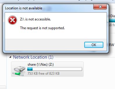

I still don't understand that 4 disks raid-z array, how can resilver two disks at same time.
I can see the root folder through other computers, but can't open it. Also the size of the folder is only 823k, it should be about 6TB. Anyway, I will wait until finishing resilvering.
