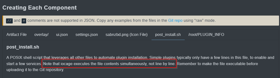

I came across the documentation for this and found this.
Is there anyway to prevent this? Make it execute the script line by line.

This appears to be a cosmetic bug, but iocage isn't running in parallel. See this older thread:
asandiego
Sep 15, 2021
Thanks. I modified the post_install script to do more debugging and it seems to be the case.
