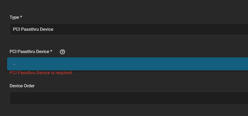

How to pass through a pcie device such as a network card to VM In SCALE
9,703
On your virtual machine, click Devices, then Add, then select the type of PCI Passthru Device, then select the device...
lspci may help you to find the device you're looking for in advance.
sagit
Dec 17, 2020
8

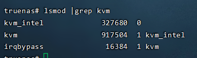

There is nothing to choose
9,703
Then you may need to check the hardware support for VT-D (VT-x in general). If it's enabled in BIOS, it should work with no need for additional tweaks of the system.
9,703
Not the same thing... you need the VT-D extension for device passthrough in addition to the base virtualization requirement of KVM.
