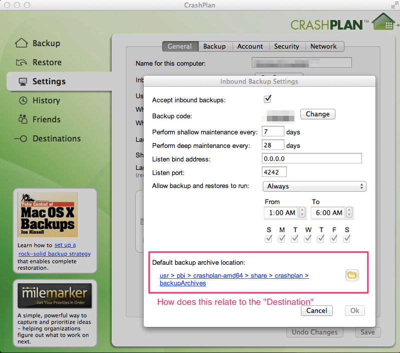

Could someone elaborate a bit on adding storage for incoming backups, i.e., backups of other computers to FreeNAS?
The sense I'm getting from the above comments is to use the Jail's storage, right?
But I'm finding just the opposite advice elsewhere:
Add Storage for incoming backups
At this point Crashplan will accept incoming backups, but it will store those backups within the jail filesystem. This is probably not desirable, so instead, configure the destination to be a path within your main ZFS pool.
  1. From the left hand tree pane, select Jails->crashplan_1->Storage->Add Storage
  2. Add the Source path within your FreeNAS pool and a Destination path, usually "/mnt/incoming". Do not tick "read-only" but do tick "Create directory"
Source: http://techflow.io/blog/crashplan-plugin-for-freenas
And then, of course, CrashPlan itself allows setting the Destination too:
noobi3

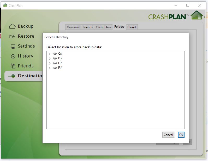

i did all the steps my crashplan on my Win 10 doesn not show the NAS folders
In the crashplan >Destination>Folders
only my own hard disks show up any help would be appretiated

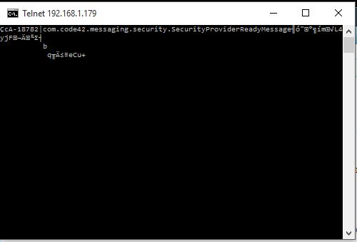

Thanks for the reply
i did telnet command from my Win 10 PC it shows its working but i dont know why it doesnt show up in my destination list in crashplan
Does your FreeNAS instance of CrashPlan show up under the list of computer destinations? (It's not supposed to appear under Folders; FreeNAS is a different computer, not a Folder on your Win10 computer.)
If not, then you didn't use the same account for both your FreeNAS and Win10 instances of CrashPlan. Either use the same account, or from the FreeNAS instance, send an invitation to the account you are using on Win10.
