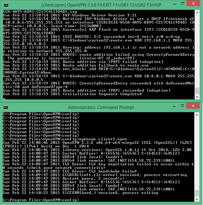

Hi, I'm trying to set up OpenVPN to be able to access my jails halfway securely outside of my home, as well as get iPlayer access when I'm travelling. I've followed the setup instructions above, and I've tested connecting locally to the vpn, and best I can tell, it works. I've set up port forwarding on my router and Dynamic DNS, but any time I try to access the server via the external IP it fails. I'd be very grateful if anyone could help, as I'm utterly stuck regarding the way forward.
Of note: It looks like Plex Media Server will happily connect using the exact same port using the same port forwarding rule (allowing TCP as well as UDP), so it would appear that the router is at least port forwarding correclty.
I've attached the output from the OpenVPN client when it tries to connect.
And yes.. I am an absolute newbie to FreeNAS/OpenVPN.
