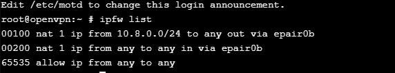

I have been trying for a bit to get this to work and I feel like I am missing something. I followed a guide I found for 11.1 I think it was. I have it working in that I can use my S9 and connect over the cell network to my openvpn jail. I can ping anything on my network internally and they can ping me back. I can resolve and ping websites external and internal to my network. Though when I open chrome and try to load any web pages they fail internal or external. Almost like its using a proxy or something though I can find nothing to confirm that. I did add a static route to my home router which is when I started being able to ping back into my vpn from internal machines.
I had an openvpn appliance running on Debian under ESX for years and it always worked fine though it has a web interface and has been generally reliable, but I am trying to move it to a jail so I dont have to keep that Dell server on all the time yet still be able to connect hit the idrac and turn it on when needed.
openvpn.conf
port 1194
proto udp
dev tun
ca /usr/local/etc/openvpn/keys/ca.crt
cert /usr/local/etc/openvpn/keys/openvpn-server.crt
key /usr/local/etc/openvpn/keys/openvpn-server.key  # This file should be kept secret
dh /usr/local/etc/openvpn/keys/dh2048.pem
topology subnet
server 10.8.0.0 255.255.255.0
ifconfig-pool-persist ipp.txt
push "route 192.168.1.0 255.255.255.0"
push "redirect-gateway def1 bypass-dhcp"
push "dhcp-option DNS 192.168.1.96"
push "dhcp-option DNS 192.168.1.98"
push "dhcp-option DOMAIN home.local"
client-to-client
keepalive 10 120
tls-auth /usr/local/etc/openvpn/keys/ta.key 0 # This file is secret
cipher AES-256-CBC
compress lz4-v2
push "compress lz4-v2"
max-clients 10
user nobody
group nobody
persist-key
persist-tun
status openvpn-status.log
verb 3
explicit-exit-notify 1
drinking12many
Apr 8, 2012
148
Ugh OK .... 5 minutes after I posted and a day and a half of work I figured it out.....
it was the compression. I am guessing the phone doesn't support lz4-v2 commented both lines out and it started working. SO then I went back and set it to just plain lz4 and that also worked so I left it as lz4.
I do wish there was a web admin packages similar to the one for the Openvpn OVA ...oh well cant have everything. :)
