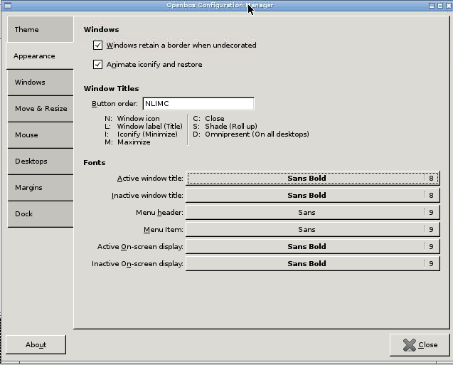

  6. You might want to configure the Openbox appearance next. Notice the window title bars are using a very small font. To tweak that, right-click the desktop to bring up the Openbox menu, hover over System, and click Openbox Configuration Manager:
  7. In the configuration dialog, choose the Appearance tab, then click each of the Fonts buttons and change the font size (I bumped all of them to 12 point):
  8. After you close the configuration dialog, activate the changes by again right-clicking the desktop, hovering over System, and clicking "Reconfigure Openbox".

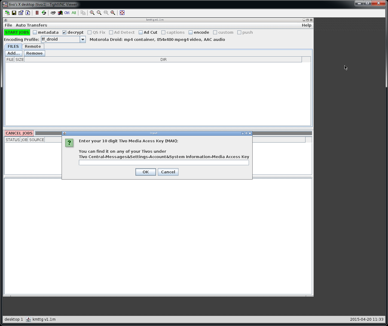

  1. Maximize the kmttg window in the VNC client, since you don't need to get at the underlying desktop any longer.
  2. Enter your Tivo's Media Access Key in the startup dialog.
