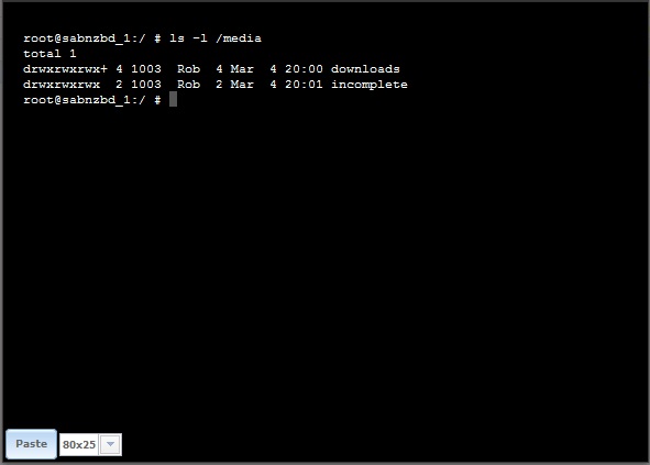

Bobbyg387
Jan 31, 2015
32
Hi Joshua,
I have been struggling with this again.
I am trying to give SABnzbd access to my storage to save downloads so Plex can access them.. I have created a dataset outside of my jail as advised. It is mounted as /mnt/V1/media
The owner of that dataset is user is Rob (1003) and group is Rob (1003) All Read, Write and Execute boxes checked. Unix Permission type.
I have added the group Rob (1003) to the jail per option 3. I then added media (user Sab runs as) to the group Rob in the jail.
When I try to update the home default folder in Sab, it won't save to my media folder, it just reverts back to /var/db/sabnzbd
What can I do to fix this?
Also- here is the output of ls-l /media from my jail:

Joshua Parker Ruehlig
Dec 5, 2011
5,949
Hi Joshua,
I'm confused by what you mean by "home default folder". do you mean completed download folder?
Bobbyg387
Jan 31, 2015
32
I seem to have gotten it figured out for now, but yeah, I meant the download folder. The issue was when I tried to update that to /media, it didn't save. I'm assuming I was having permission issues, but I just added
'media' UID 816 in the FreeNAS GUI and made that the owner of the dataset and that seems to have done the trick.
Dec 5, 2011
5,949
I'm seeing a lot of people on here having trouble with permissions and CIFS shares. There's a lot going on when you try to install SAB, CP, SR and Plex, giving each proper permissions and then setting up a CIFS share.
Maybe I'm confused (most likely), but you have to add the user that each plugin runs as in the GUI now right? I changed my permission settings in my windows, giving everyone full access. Not ideal, but I don't understand permissions enough to allow users media and plex to access the folder and also have my CIFS share setup properly.
glad you got it working. yeah it gets pretty complicated once you start mixing multiple plugins+CIFS.
