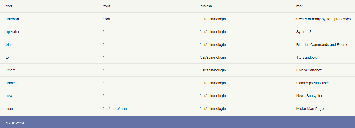

I have a lot of confusion in 11.2-BETA trying to split my data up into different datasets. Here's what I did:
  1. created a dataset "Test" under an existing dataset "Tank" that is working with everything
  2. created a test file "test1" via a Jail command line
  3. tested the datatest "Test" over Samba network share which is a different user, could not access the folder
  4. changed dataset "Test" owner from root to the user that the Samba share uses
  5. Samba share can now write to "Test" and created test file "test2"
  6. the Jail user can only see "test1" and the Samba user can only see "test2"
What is the simplest way to have multiple datasets where Jails can access everything, Samba can access everything, but Plugins can only access certain datasets?
Also what are all these different users/groups that are in FreeNAS by default? news, man, games, etc - am I really supposed to mix these in with the actual custom users that I want to use? Can I just delete all these defaults? Why are they even there?
How do the new 11.2 plugins manage data like configs/logs? There are a bunch of generic mount points provided by default but I don't understand the implications of backup/upgrade/restore of this mechanism and I can't find it documented.
If it would be better to start a separate thread let me know! I have been trying to figure out the best practices for the new plugin system and want to use datasets whereas before I just had one big group writable directory.
I don't know if this is helpful, but I understand there are some bugs with 11.2 BETA. I was on it for a while and had a world of problems with plugins and jails. It's unfortunate that FreeNAS steers the downloads default to this beta, and I had to redo my entire rebuild when I found out about the bugs. Best of luck.

Am trying to set Transmission on my freenas box having some problems with premissions.
I did install transmission plugin, but under user and grup list I can not find any user associated to Transmission.
If I run command ps aux in jail I get
root@transmission_1:/ # ps aux
USER PID %CPU %MEM VSZ RSS TT STAT STARTED TIME COMMAND
root 31598 0.0 0.2 144012 40200 - SJ 21:33 0:02.63 /usr/pbi/tran
root 31647 0.0 0.0 10464 1928 - IsJ 21:33 0:00.01 /usr/sbin/sys
root 31713 0.0 0.0 12564 1848 - IsJ 21:33 0:00.01 /usr/sbin/cro
transmission 79736 0.0 0.0 82800 7436 - SsJ 21:54 0:00.27 /usr/pbi/tran
root 88751 0.0 0.0 19676 3012 1 SsJ 22:24 0:00.01 /bin/csh
root 88754 0.0 0.0 21244 2096 1 R+J 22:24 0:00.00 ps aux
tl.dr
I want to know what user ID is transmission using so I can set chmod to 775 and add Transmission user to be a member of group that owns torrent directory.
Thanks :)
