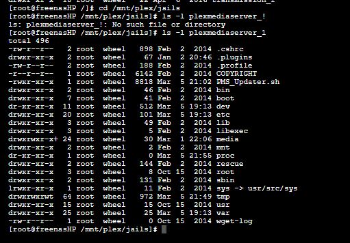

rubenm
Oct 5, 2013
28
Hi All
I have a situation since the bigining that i never find a solution.
My plex works, but i f i want to delete something, i have to go with the CIFS file and delete plex as no permission.
How can i correct that, without it stop working?

Drew Heath
Mar 7, 2016
80
Do you recall if you used the group or user method to access the files? As there are a ton of ways it could be setup, lets decide on a method that you want to use and move from there.
As an example, if you wanted to use the group method, you could create a group called media, and add the plex user to the media group.
Step 1, create the media group: pw groupadd media
Step 2, add the plex user to the media group: pw groupmod media -m plex
Step 3, verifiy plex is a member of media: id plex
Step 4, set the media group to the media files: chown -R :media "path to media files"
Step 5, set access rights for owner and group: chmod -R 770 "path to files"
(note, this assumes no guest access)
Step 6, verify access changes: ls -l "path to media files"
(you should see -rxwrxw--- Files if correct drxwrxw--- for directories)
Plex should now be able to access the files.

on step 4 i get "Operation not permitted"
Drew Heath
Mar 7, 2016
80
How are permissions set on the dataset that is presented to the jail? It must have at least as much permission are you are trying to give. If you only gave read at the dataset, you wouldn't be able to grant write in the jail.
