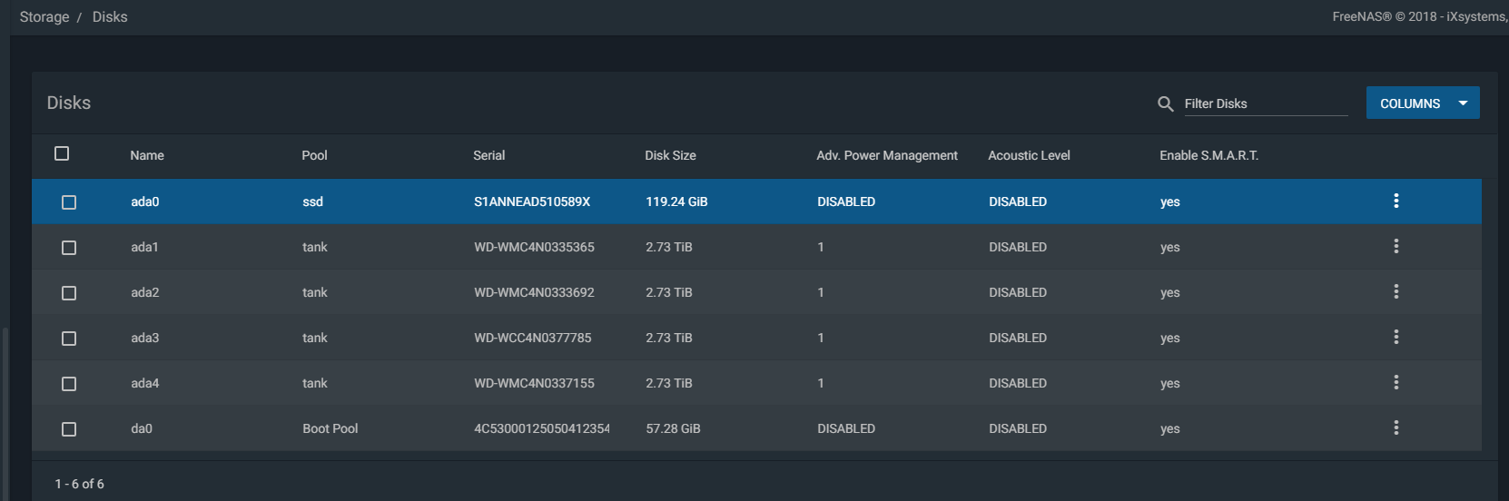

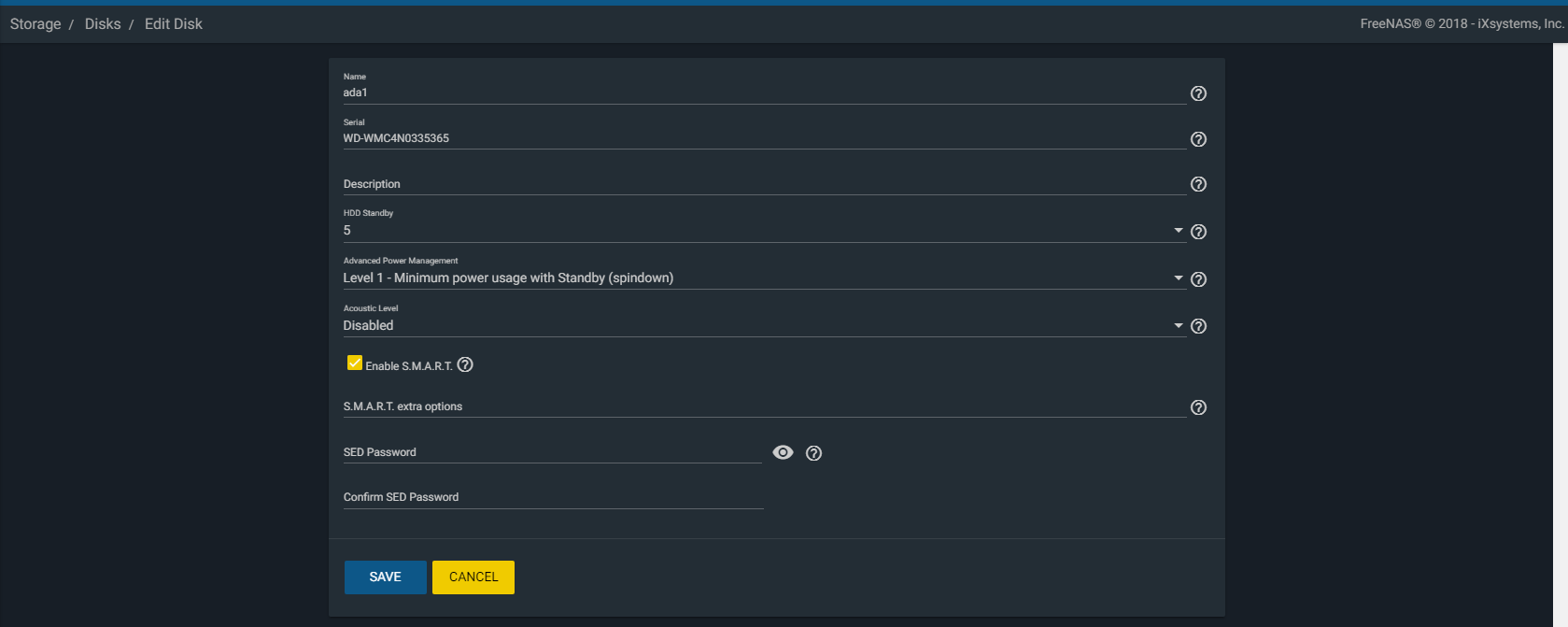

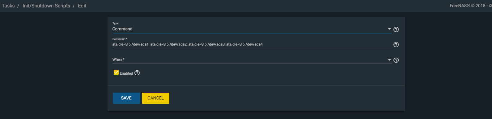

ric
Member
Dec 22, 2013
176
I've tried everything all the commands to put my HDs to sleep/standby mode that they have suggested here in the freenas forum but the HDs dont spindown!
Is this because of my HDDs do not support spindown/idle or what?
Services / SMART > Power Mode* Standby
Aug 14, 2019
6
