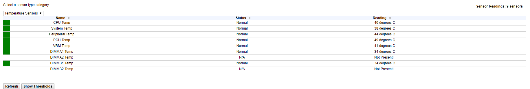

So I've done the following
1. shut down the server
2. flipped the power switch on the PSU to off for awhile
3. moved the AIO from Fan2 (previously had it on fan1) to Fan4 (I thought it was fanA (just realized that mistake)
4. switched the AIO from PWM control to Auto.
5. powered on
And now it's properly quiet and the idle CPU temp is about 24c (or 35c, the sensor reading keeps bouncing.)
So this should be good.
Thanks.
