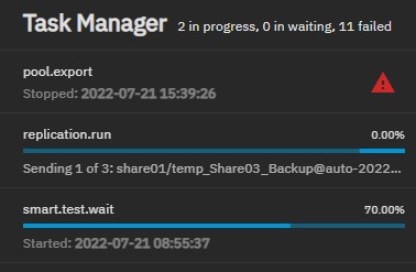

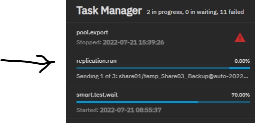

TrueNAS-SCALE-22.02.2.1: I have a replication.run task that I want to cancel. I have been searching but I cannot find how to do this. I have seen a couple of suggestions to go to the shell, use htop to identify the process and the kill command. But there must be a way to cancel a task with the TrueNAS UI? Thanks for any pointers!

Thanks, that would be the right place ... if I had done things correctly. When I created that replication task, I think I did it all wrong. And it is not being recognized as a configured replication task. If it were and showed up in the replication task pane, there would be a little trash can to delete it. Also note that I have a SMART Test running, which I kicked off in Storage -> Disks -> select three dots beside a disk and "Manual Test") and this is not showing up in the Smart Tests pane. I would also like to kill this test. Note that re-booting does not get rid of these.
Maybe I am stuck with htop and kill. Problem is, I don't know which out of the hundreds of processes relates to these two tasks.

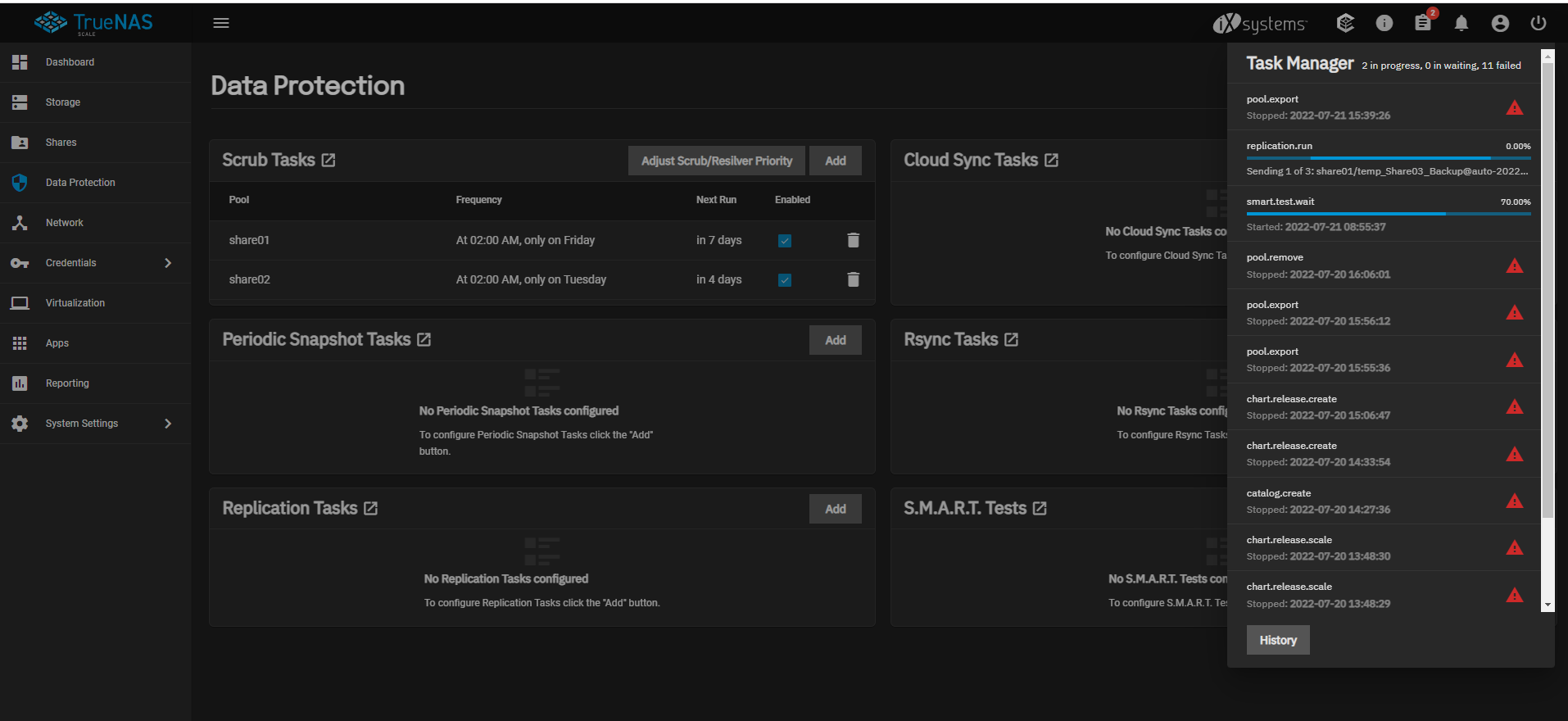

@morganL I can start with the simpler of the two: I can recreate the behavior of a manual SMART Test but I am unsure what I did wrong with the replication task.
SMART Test: I made a nice little mp4 of what I did but, unfortunately, cannot load it here. :( So I will attempt to describe it.
  1. I go to "Data Protection" and see that the "S.M.A.R.T. Tests" pane says "No S.M.A.R.T. Tests configured".
  2. I go to "Storage" -> "Disks" ->"Disks" and click on the three dots beside one of my HDDs, and select "Manual Test".
  3. I ask for a LONG test and "Start". It says it is expected to run until a few hours from now.
  4. In the Tasks Manager, I can see this new test running as smart.test.wait at 10%.
    I go back to "Data Protection" and see that the "S.M.A.R.T. Tests" pane still says "No S.M.A.R.T. Tests configured". If my new task were to show up here, I could trash it. I have no idea how I can stop it.
Is this surprising? Does it make sense to report this?
Samuel Tai
Apr 24, 2020
5,399
You misunderstand the Data Protection tab. It’s essentially a front end for the system crontab, and doesn’t track running jobs. The GUI tracks running jobs in the Task Manager on the top bar, under the icon that looks like a clipboard.

You've started a single manual test.... if you created a periodic task, you could delete it on this page. Is that the confusion?
