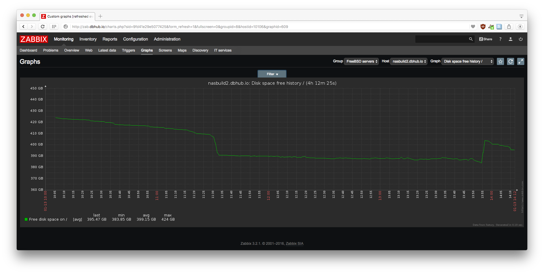

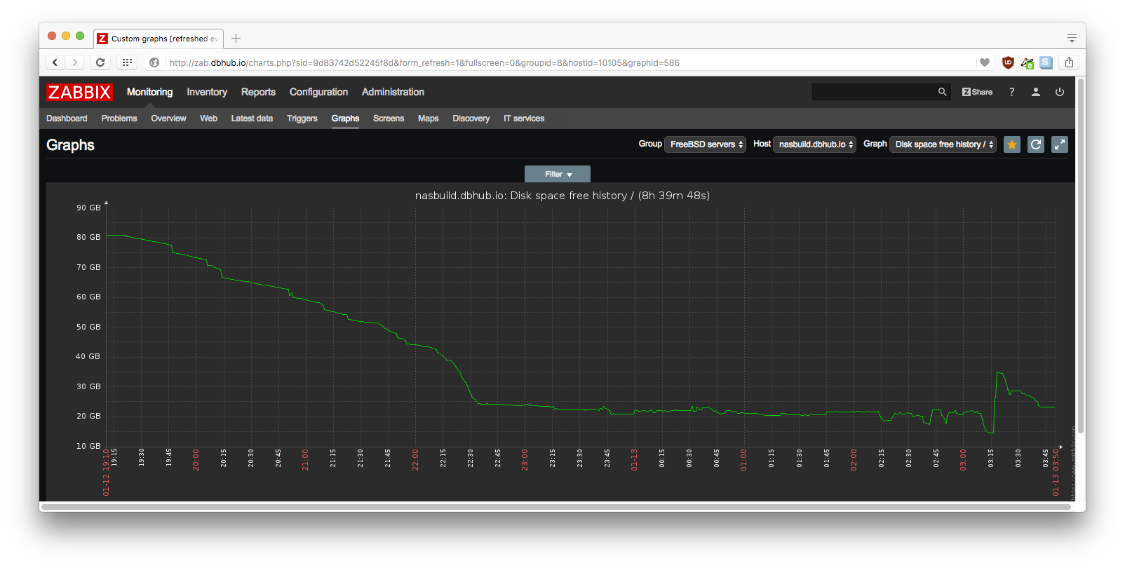

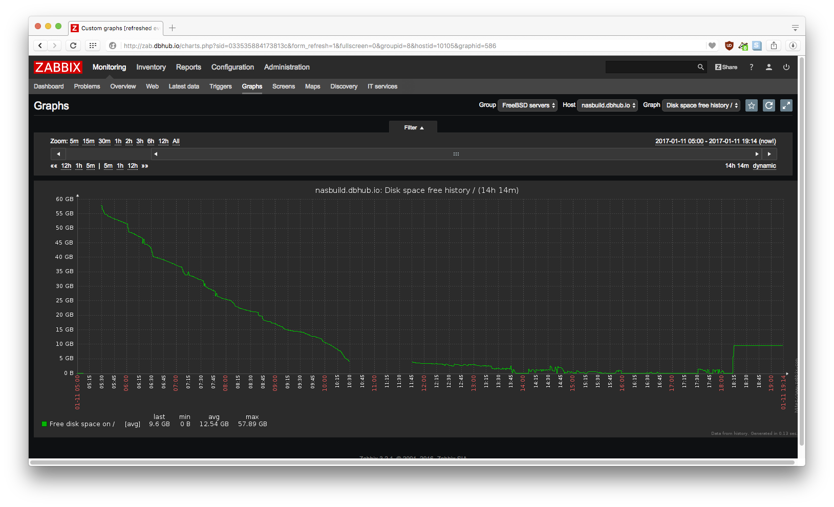

This shows free disk space.  Starts out ~60GB, and continues into the ground/failure. ;)

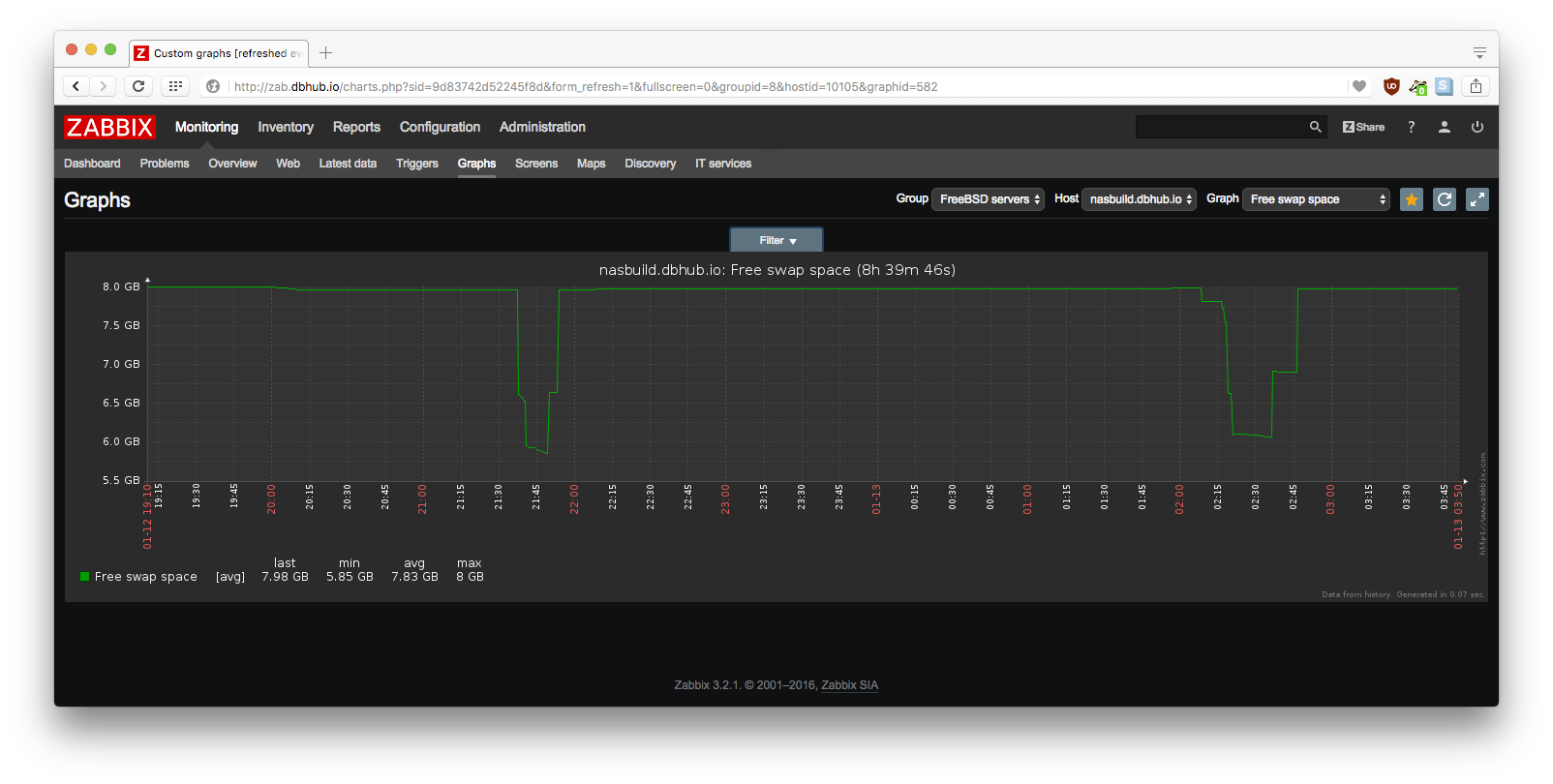

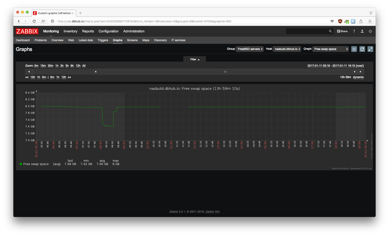

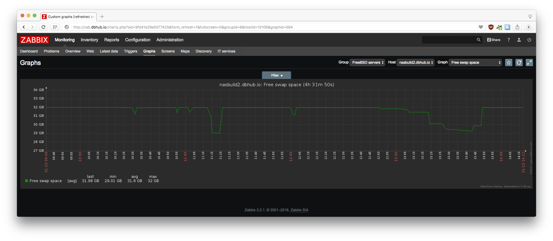

This shows the amount of free swap space.  With 12GB of RAM, and 8GB of swap, the compile process (in this failed run) didn't get very far into swap.	Not even 1 GB used.  A full (successful) run may be different.

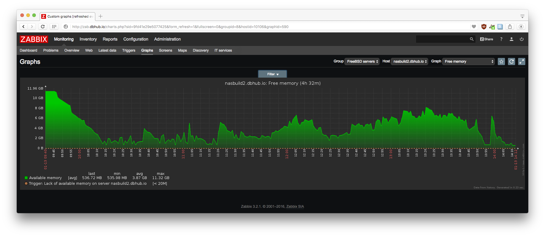

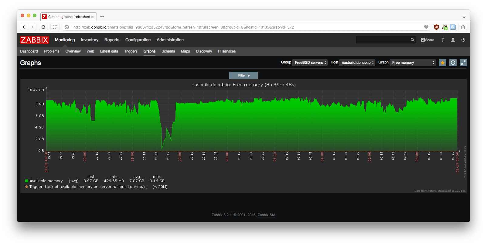

Memory usage.  There seems to be only one significant section of memory pressure, ~08:00am to ~08:45am.  That timeframe corresponds to the only significant swap usage period in the graph above.  At a rough guess, it's probably during either the buildworld or buildkernel phase, rather than during the lengthy port building which comes after.
If we want to reduce memory usage, we could probably look into environment variables affecting buildworld/buildkernel.  Maybe something to limit the # of threads there, similar to what POUDRIERE_JOBS does for port building.

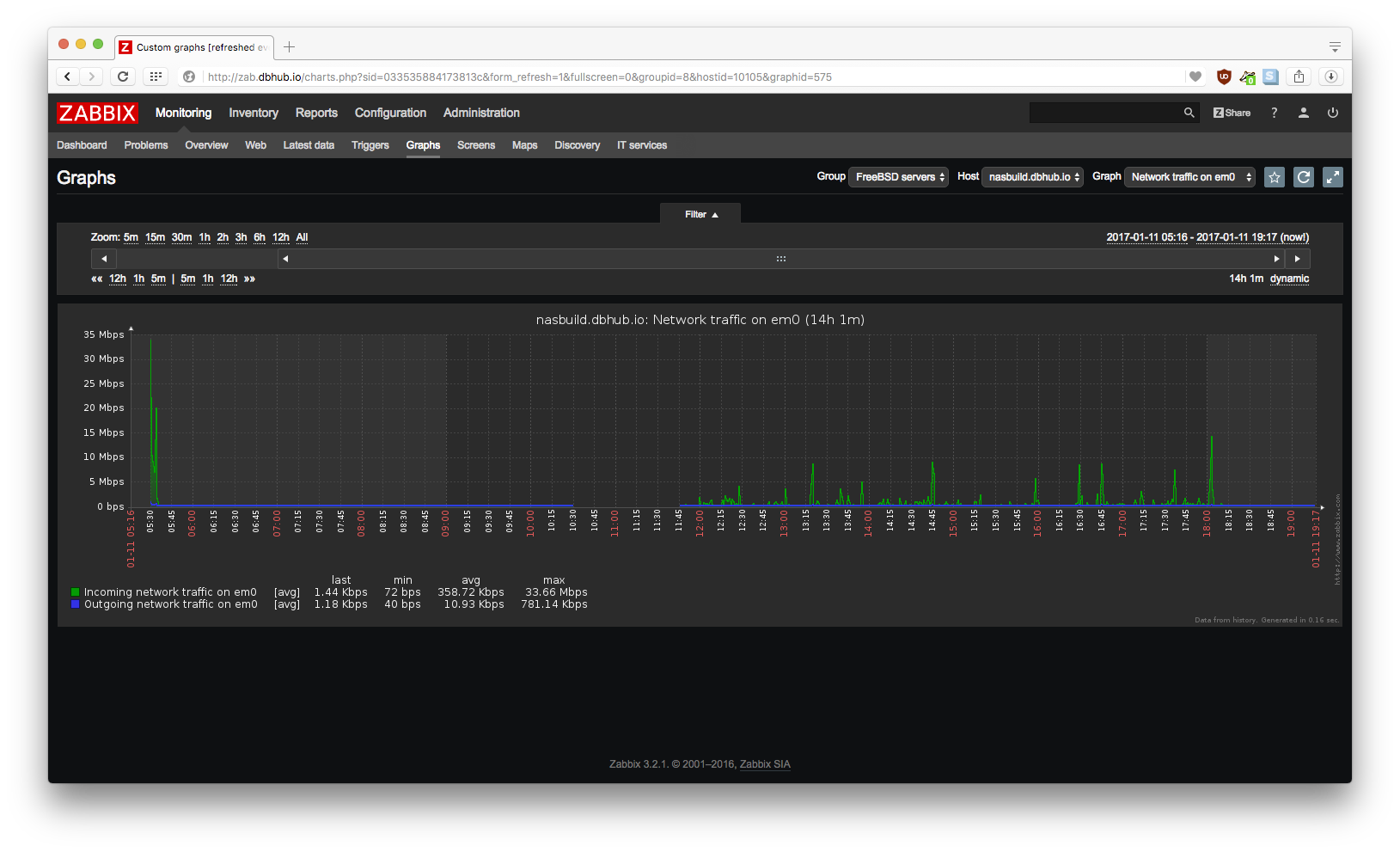

Network traffic.  The initial download of packages and source near the start, and not much after that:
