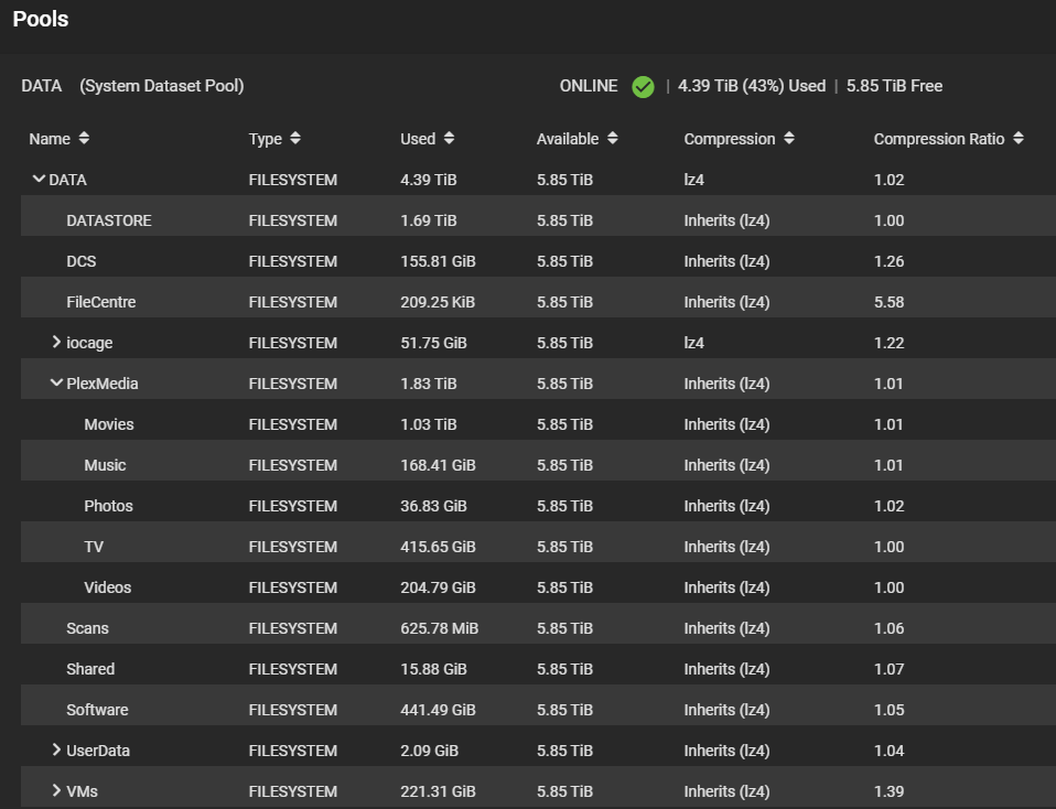

* My TrueNAS Implementation *
TrueNAS is setup with a single Pool - DATA of 4x6Tb (RAIDZ2) - provides a total of just over 10Tb of storage.
4.38 TiB is in use.
Breakdown as follows:

THE BELOW APPEARS TO WORK WELL - When run manually from a terminal shell command
# Backup Subset1 ** MEDIA DATA TO OFFSITE 3 Tb USB DISK **
# Subset1 approx 2.69 Tb (Should copy across to 3 Tb Disks)
cd ..
cd /
kldload fuse
cd mnt
mkdir ntfs
ntfs-3g /dev/da0p1 /mnt/ntfs
rsync -avhP --delete-before /mnt/DATA/PlexMedia/Movies /mnt/ntfs/DATA
rsync -avhP --delete-before /mnt/DATA/DATASTORE /mnt/ntfs/DATA
umount /mnt/ntfs
# Backup Subset2 ** WORK DATA TO OFFSITE HP DISKS **
# Subset2 approx 1.66Tb (Should copy across to 2Tb Disks)
kldload fuse
cd ..
cd mnt
mkdir ntfs1
ntfs-3g /dev/da0s1 /mnt/ntfs1
rsync -avhP --delete-before /mnt/DATA/Scans /mnt/ntfs1/DATA
rsync -avhP --delete-before /mnt/DATA/DCS /mnt/ntfs1/DATA
rsync -avhP --delete-before /mnt/DATA/Shared /mnt/ntfs1/DATA
rsync -avhP --delete-before /mnt/DATA/FileCentre /mnt/ntfs1/DATA
rsync -avhP --delete-before /mnt/DATA/Software /mnt/ntfs1/DATA
rsync -avhP --delete-before /mnt/DATA/UserData /mnt/ntfs1/DATA
rsync -avhP --delete-before /mnt/DATA/VMs /mnt/ntfs1/DATA
rsync -avhP --delete-before /mnt/DATA/PlexMedia/Music /mnt/ntfs1/DATA
rsync -avhP --delete-before /mnt/DATA/PlexMedia/TV /mnt/ntfs1/DATA
rsync -avhP --delete-before /mnt/DATA/PlexMedia/Photos /mnt/ntfs1/DATA
rsync -avhP --delete-before /mnt/DATA/PlexMedia/Videos /mnt/ntfs1/DATA
umount /mnt/ntfs1
