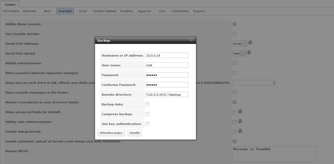

So I deepened my research and on the documentation I found that you can make a backup with a dedicated wizard if you go to:
System --> Advanced --> Backup
Question: does this save plugins and jails? (I don't want to save ALL the data - movies, etc. - on my HD, but only plugins and jails and the overall config)
Anyway, I could not manage to make the backup work, probably because I make some mistakes in filling out the backup wizard.
I attach the screenshot of the error and of the wizard that you have to fill
Nope, wrt jails that option only saves the location of the jail root.
You could replicate a snapshot of the jail's dataset to another system should you need to restore that jail.

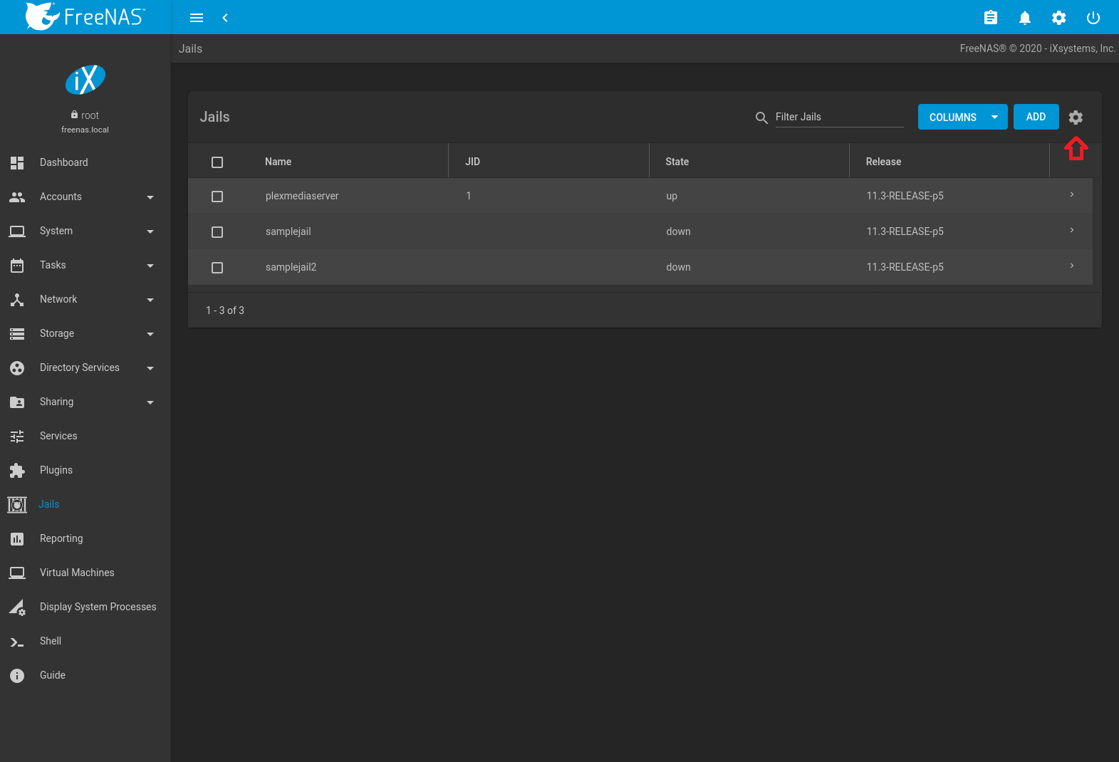

The boot pool has nothing to do with the iocage pool. In Jails, click the little gear:
This will allow you to set the pool iocage uses. If this is already set to your data pool, you're set. If not, set it to where your data pool resides. Then you can run the import.
