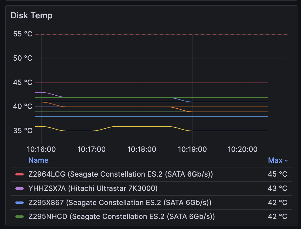

Problem: The problem I was trying to solve was getting hard drive temperatures to Grafana (the prometheus app worked great out of the box for a variety of other TrueNAS metrics via the included node-exporter, but not HDD temps).

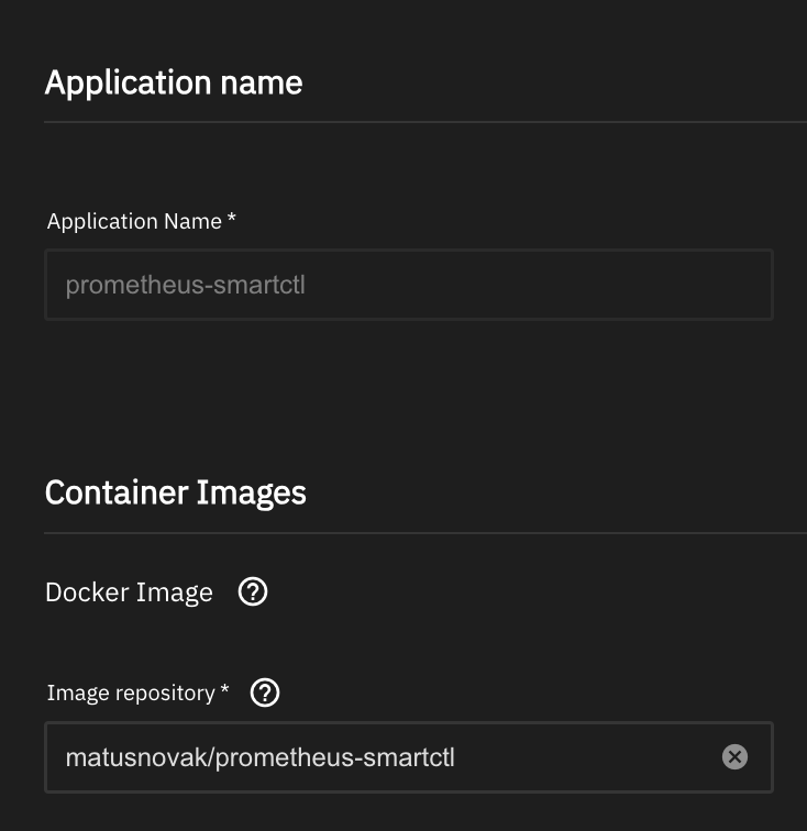

  1. Install a custom App from the prometheus-smartctl docker image (thanks to the maintainers of this repo, it works like a charm!)
    1. Click "Discover Apps" -> "Custom App"
    2. Enter "matusnovak/prometheus-smartctl" in the "Image repository" field

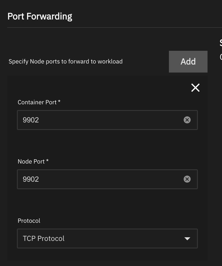

    3. Add port forwarding to 9902

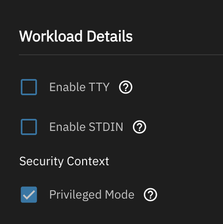

    4. It's important that you check the "Priveleged Mode" box so that it has access to smartctl
      NOTE: Do this at your own risk! Presumably this effectively gives sudo to the container, so only proceed if you trust the contents of the docker image to have access to everything on your host!

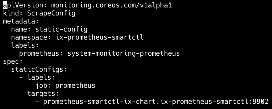

    2. Create a new yml file somewhere temporary (e.g. `vim /tmp/prom-smartctl-scrape-config.yml`
    3. Insert your namespace and name into the following and save:
      apiVersion: monitoring.coreos.com/v1alpha1
      kind: ScrapeConfig
      metadata:
        namespace: <your-namespace>
        labels:
          prometheus: system-monitoring-prometheus
      spec:
        staticConfigs:
          - labels:
              job: prometheus
            targets:
              - <prom-smartctl-app-name>.<prom-smartctl-app-namespace>:9902
    4. Run the following kubectl command:
      sudo k3s kubectl apply -f <scrape-config-yml-location>
  3. That's it! For me, prometheus-operator discovered the new CRD object within seconds and the new `smartprom_` metrics started showing up in Grafana.
    (I had the best success with the `smartprom_temperature_celsius_raw` metric
