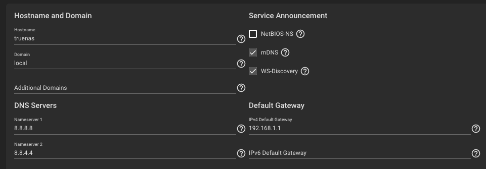

You can chalk this up to me not being smart. But, I've done a bunch of searching and I'm stuck on it.
How does the truenas.local domain work?
This is what is happening.
Mac A:
- wired, DHCP IP
- Go > "Connect to Server..." smb://truenas.local works.
- Go > "Connect to Server..." smb://<static IP> works.
Mac B:
- wireless (Unifi), DHCP IP
- Go > "Connect to Server..." smb://truenas.local does NOT work.
Thoughts on why DNS is not working on Mac B but it is on Mac A?

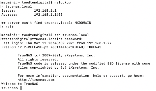

nslookup:

Unless your DNS domain is explicitly set to .local, .local domains use multicast DNS on port 5353, instead of unicast DNS on port 53. For multicast to work in your layer 2 subnet, your wireless bridge needs to grok IGMP on both the wired and wireless sides of the bridge.

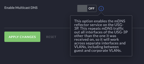

I found this (in Unifi) and truenas now shows up in the sidebar (like Bonjour).
truenas.local still doesn't work on the wireless computers.

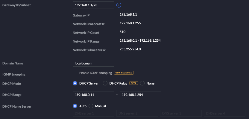

This looks promising. Does this pane (in Unifi) perhaps need "localdomain" set to "local" and IGMP snooping turned on?

As sort-of mentioned above, the use of "local" as an internal domain is likely to cause problems, because it interferes with mDNS. Try "localdomain" to confirm or disprove as a next step.

Aaah. I see. Looking into that, thanks.
