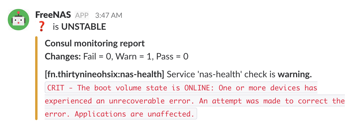

I got this message so I guess it is working. I'm not sure what to do with the information in it, but sounds like something (scary) happened!

I got this message so I guess it is working. I'm not sure what to do with the information in it, but sounds like something (scary) happened! View attachment 21062
yg01m
Nice!
Can you post a screenshot of your Slack notification config?
PS: Go to System>Boot, click on ‚Status’ to see which device failed.
Your boot pool (where FreeNAS was installed -probably a USB Flash drive(s)) has a failed device, you’ll need to replace it.

You have a potentially-corrupted boot device that should be at least checked (and most likely replaced if it is a USB stick) following the guide's information for your version of FreeNAS.

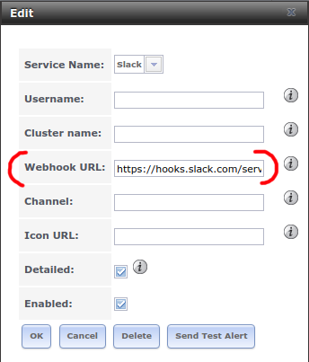

OK, so I installed 11.1-RC1 beta this morning, and now the fake alerts are firing and heading in to Slack as expected. The only piece of information that is needed is the URL for the webhook. Everything else is set in the webhook itself, so unless you want to override the username/channel you can leave them blank.

alx.balmus
Jan 27, 2018
All you need to set up in the Slack Alert configuration window in FreeNAS is the Webhook URL.
The Webhook URL behaviour and configuration can be done ont he Slack website. You can configure there the username, channel, and icon.
