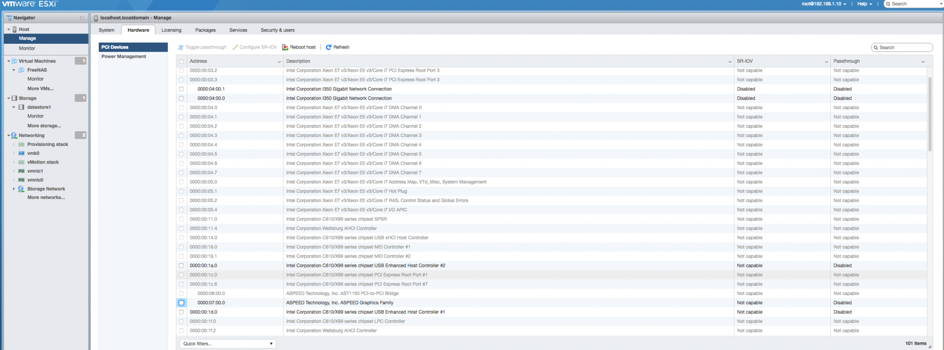

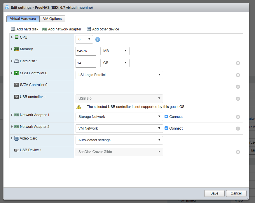

Hi Guys, i have a problem cant passthrough AHCI Controllers, i have X10SRI -F with 8 x HGST 4T one intel ssd run ESXi (see all my system below). in the bios total i have two groups SATA and eSATA which i can see that are showing plugged in, in the ESXi i have two Wellsburg AHCI Controllers greyed out which i assume are my bios SATA groups. both groups where already enabled before i installed the ESXi 6.7 and FreeNAS 11.2 BETA2 VM. in the ESXi CLI passthrou.map i added the AHCI IDs and rebooted, but it's not working still greyed out. is there any workaround to fix it for now with my current hardware as its my production machine, sorry i couldn't wait :) . i plan to get better SSD, NICs and if necessary PCI cards for the HDD soon.

# CUSTOMS
# Intel Wellsburg AHCI Controller
8086 8d02 d3d0 false
8086 8d62 d3d0 false
# /CUSTOMS
# Intel 82579LM Gig NIC can be reset with d3d0
8086  1502  d3d0	 default
# Intel 82598 10Gig cards can be reset with d3d0
8086  10b6  d3d0	 default
8086  10c6  d3d0	 default
8086  10c7  d3d0	 default
8086  10c8  d3d0	 default
8086  10dd  d3d0	 default
# Broadcom 57710/57711/57712 10Gig cards are not shareable
14e4  164e  default  false
14e4  164f  default  false
14e4  1650  default  false
14e4  1662  link	 false
# Qlogic 8Gb FC card can not be shared
1077  2532  default  false
# LSILogic 1068 based SAS controllers
1000  0056  d3d0	 default
1000  0058  d3d0	 default
# NVIDIA
10de  ffff  bridge   false
FreeNAS Shows
[root@freenas ~]# camcontrol devlis
<VMware Virtual disk 2.0> at scbus2 target 0 lun 0 (pass0,da0)
<SanDisk Cruzer Glide 1.00> at scbus4 target 0 lun 0 (pass1,da1)
