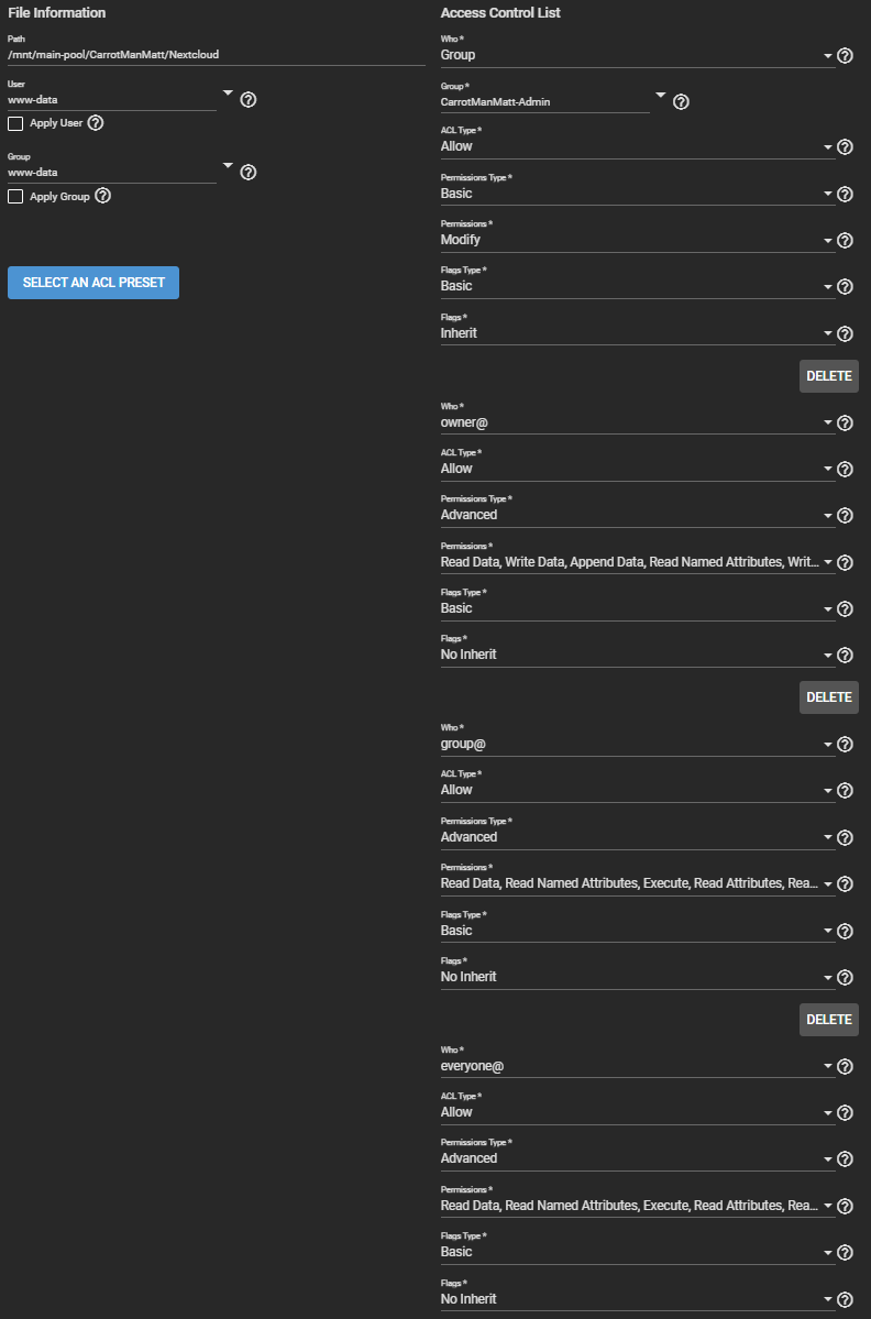

Having some fun NFS permissions difficulties with connecting it to my Nextcloud docker container:
I have a TrueNAS server running with a storage pool & NFS share. In the AccessControlList of the storage pool, the user is set as www-data & group of www-data (See attached image). This is a user & a group I have manually created in TrueNAS with a UID & GID of 33. This is to match with the inner user within the Nextcloud docker container that accesses this data.

Yh! turns out I just needed to check the `inherit` permissions check box on the ACL page. This was preventing the www-data user from creating new files even though it owned all the data.
Hope this helps!
