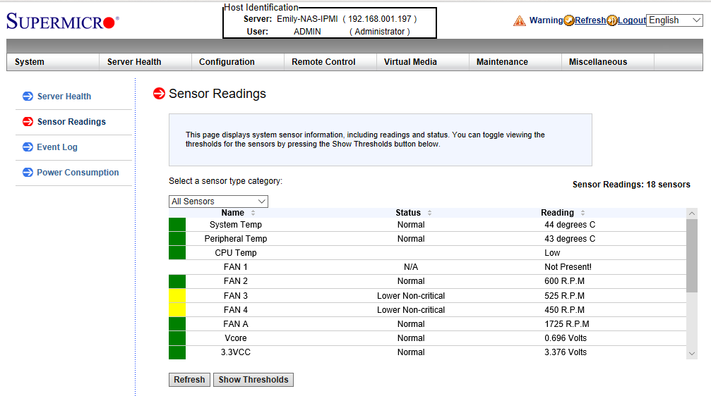

Do you know how to look at the temperature in the IPMI web page? Should look like this:

Open up a console and see what's going on. You've got IPMI on that motherboard, use it.

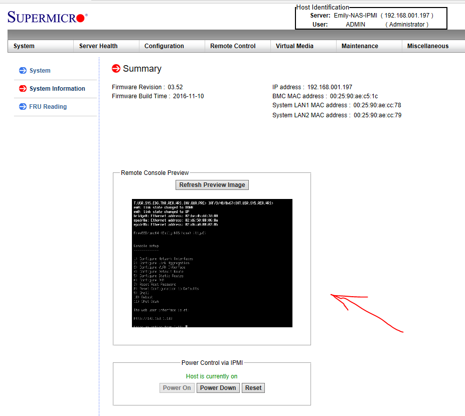

One of the pages in the IPMI web interface will look similar to this:
and on that page you can see a preview of what the console would look like.

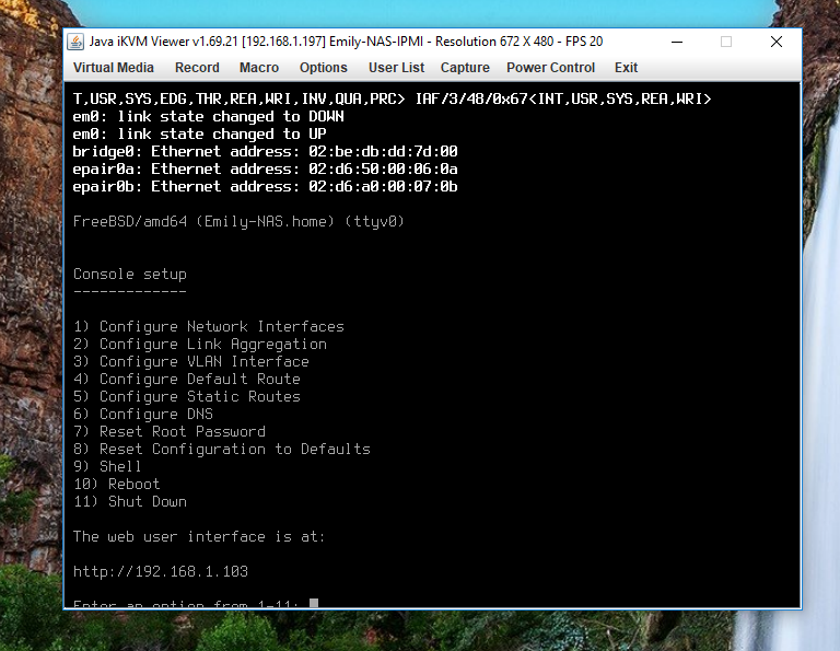

Just click on that to launch the Java iKVM Viewer which will give you interactive control, from you desktop.
Looks like this:
This is one of the main reasons we buy a server board to begin with. No need to ever connect Monitor, Keyboard, Mouse or CD-ROM because they can all be connected remotely using this utility.
