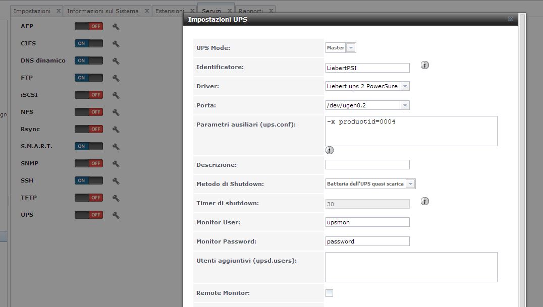

Hi, I'm running the last stabel Freenas version [FreeNAS-9.2.1.3-RELEASE-x64 (dc0c46b)] and I'm tryin' to get my USB connected UPS working.
The UPS is an "Emerson Power Liebert PowerSure PSI 1440" wich is not supported by NUT.
I tryed using all belkin and liebert models in list, but it wont' works.
Here is a console log, and attached you can find a screen of my config. Any help is welcome :)
Apr 2 13:58:00 archivio notifier: This Liebert device (10af:0004) is not (or perhaps not yet) supported
Apr 2 13:58:00 archivio notifier: by usbhid-ups. Please make sure you have an up-to-date version of NUT. If
Apr 2 13:58:00 archivio notifier: this does not fix the problem, try running the driver with the
Apr 2 13:58:00 archivio notifier: '-x productid=0004' option. Please report your results to the NUT user's
Apr 2 13:58:00 archivio notifier: mailing list <nut-upsuser@lists.alioth.debian.org>.
Apr 2 13:58:00 archivio notifier: Network UPS Tools - Generic HID driver 0.38 (2.7.1)
Apr 2 13:58:00 archivio notifier: USB communication driver 0.32
Apr 2 13:58:00 archivio notifier: No matching HID UPS found
Apr 2 13:58:00 archivio notifier: Driver failed to start (exit status=1)
Apr 2 13:58:00 archivio notifier: Network UPS Tools - UPS driver controller 2.7.1
Apr 2 13:58:00 archivio root: /usr/local/etc/rc.d/nut: WARNING: failed precmd routine for nut
Apr 2 13:58:00 archivio notifier: /usr/local/etc/rc.d/nut: WARNING: failed precmd routine for nut
Apr 2 13:58:00 archivio notifier: nut_upsmon not running? (check /var/db/nut/upsmon.pid).
Apr 2 13:58:00 archivio notifier: Starting nut_upsmon.
Apr 2 13:58:00 archivio notifier: kill: No such process
Apr 2 13:58:00 archivio notifier: UPS: LiebertPSI (master) (power value 1)
Apr 2 13:58:00 archivio upsmon[95132]: UPS [LiebertPSI]: connect failed: Connection failure: Connection refused
Apr 2 13:58:00 archivio upsmon[95132]: Communications with UPS LiebertPSI lost
Apr 2 13:58:00 archivio notifier: nut_upslog not running? (check /var/db/nut/upslog.pid).
Apr 2 13:58:00 archivio notifier: Starting nut_upslog.
Apr 2 13:58:00 archivio notifier: Warning: initial connect failed: Connection failure: Connection refused
Apr 2 13:58:02 archivio notifier: Stopping nut_upslog.
Apr 2 13:58:02 archivio notifier: Waiting for PIDS: 95160.
Apr 2 13:58:02 archivio notifier: Stopping nut_upsmon.
Apr 2 13:58:25 archivio upsmon[95131]: upsmon parent: read

solved by NUT mail list users. I removed the leading "-x" in freenas GUI config and now it works :)
