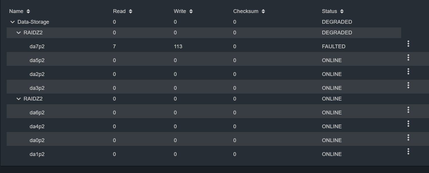

Hi guys i had a 1 second power trip, Freenas server i could not see it shutting down and restarting. However the pool is degraded. i have not re started it yet but i am not sure if it is a real issue or after i re booted it will be back to normal. 1 of the disk da7 have read and write errors, from GUI it is in 'faulted' state now.
And if i change disk, these are the steps from GUI ?
1. Plug in new disk without removing faulted disk which is da7
2. At da7>replace disk>replace it with new disk
or
1. Remove da7
2. Plug in new disk>replace
or
1. Offline da7 and remove physically
2. Insert new disk>replace
i really have phobia from last 2 weeks experience where pool cannot be seen.

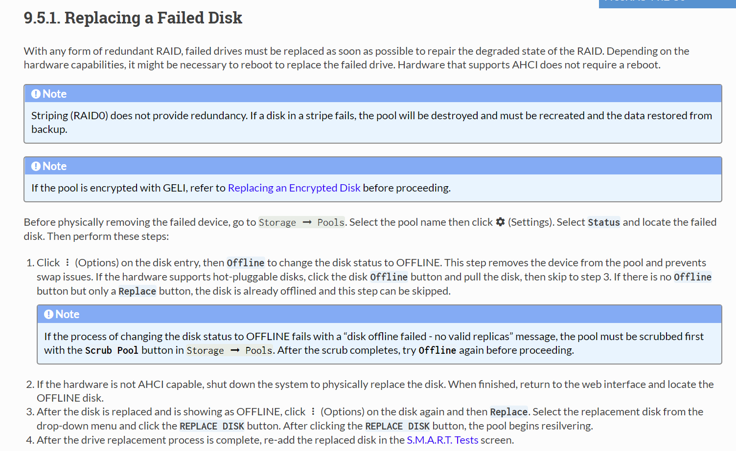

OK guys, the pool is Data-Storage & looking at the manual
1. Offline the disk da7 from GUI
2. Power down to remove da7, insert new disk
3. Power up and GUI & look for the Offline new disk to replace disk in pool Data-Storage.
4. Let it re silver, then pool becomes healthy again.
5. If above not right please let me know
Question : i am going to re boot first and see if pool is still degraded or do a scrub first before i re boot.(have not done a scrub for a year but i am not sure if it helps or will worsen the condition)
Appreciate opinions and experience please

update: upon re boot server went back to normal healthy condition. (1 data error is due to the previous experience)

I would do a scrub on the data pool and a long SMART test, a reboot clears the error list.

thanks for the advice, long smarts done

thanks Philo, the hot swaps does not seem to work, i tried and it always crashes.
if there is a disk faulted or spoiled, in future i'd do it this way from the manual
"Offline the disk da7 from GUI
4. Let it re silver, then pool becomes healthy again."
this is the right way ya ?
Looks right to me; I wouldn't argue with the User Guide on this one. :)
