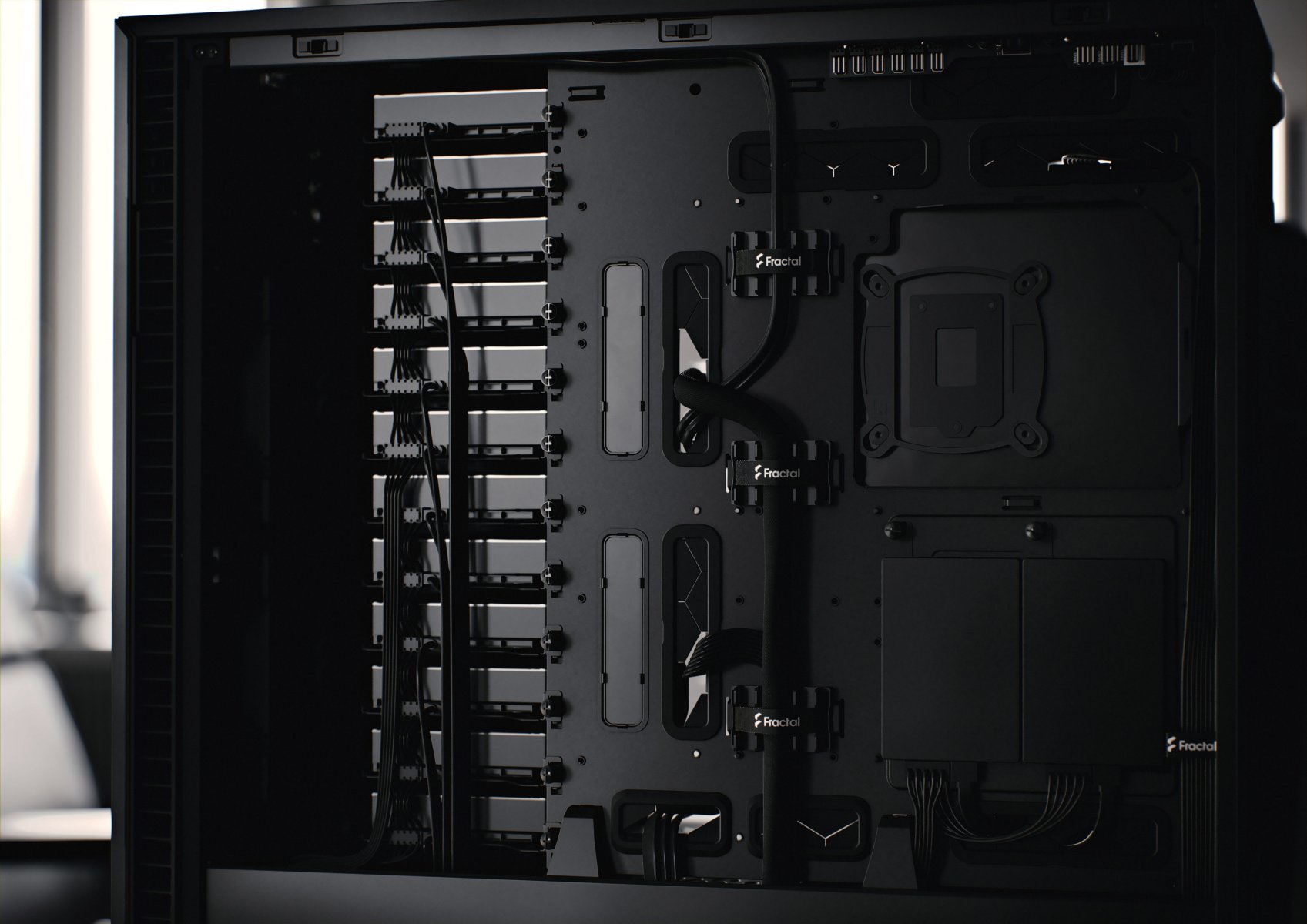

I finally got my Fractal Design Define XL case. I am looking for some help with cabling.
Fractal_Design_Define_7_Define_7_XL_Feature_Visuals_CableManagement._Dark-3840x2716.jpg
I will be installing 12 hard drives. Any idea where I can find the hard drive cables?
Thank you.

Cases do not come with SATA cables

That depends what you're connecting the drives to. Most convenient would be SAS breakout cables from a HBA. The motherboard may come with some cables.
Boy, I don't even want to think about the amount of man-hours that would have gone into getting all those cables ready for the shoot, were it not a render.
The nice thing about computer graphics is that they're disconnected from reality and its ugly bits like elasticity in the cables, weight of the cables or the fact that SATA cables do not magically merge together into a single cable, making a neat wiring loom sort of thing.
It depends on what your controller has. I have a SAS controllers capable of running SATA drives with these cables:
HOWEVER, I also have:
SFF-8643 to (4) 29Pin SFF-8482 SATA (two different styles of them)
SFF-8087 to (4) 29pin+15Pin SFF-8482 SATA
(it depends on the HBA connector and drive on the other end)
without the power dongles (to save space in the case)
Though you might need these if you're running off the mainboard:
You'll probably also need some sort of power splitter like:
I'll mention this again for completeness:
50pcs /100pcs Releasable Cable Ties --they come in different lengths, 15cm works inside cases well.
Fire it up without the drives in and see how loud it is, you may want to spend a bunch of money on fans (unfortunately).
