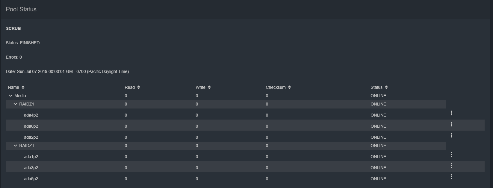

I have 2 unused 6TB HDDs that I want to add to my current pool. I've done this in the past with 3 new HDDs but it's been a while since I've attempted this and I really don't want to mess things up. So I'm hoping someone could give me some guidance. Here's a screen grab of my current pool status. Thanks in advance.

There really isn't going to be a good way to add two disks to this pool. You could add them as a mirrored vdev, but it's preferred that all vdevs in a pool match in number of disks, type, and ideally size of disks. If you can get a third disk and have room for all of them in your case, that would be better.

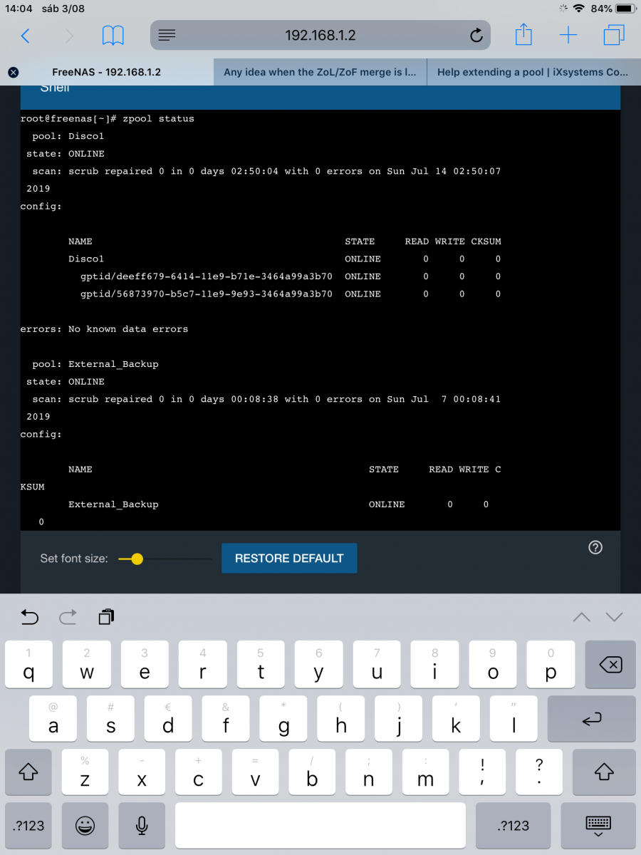

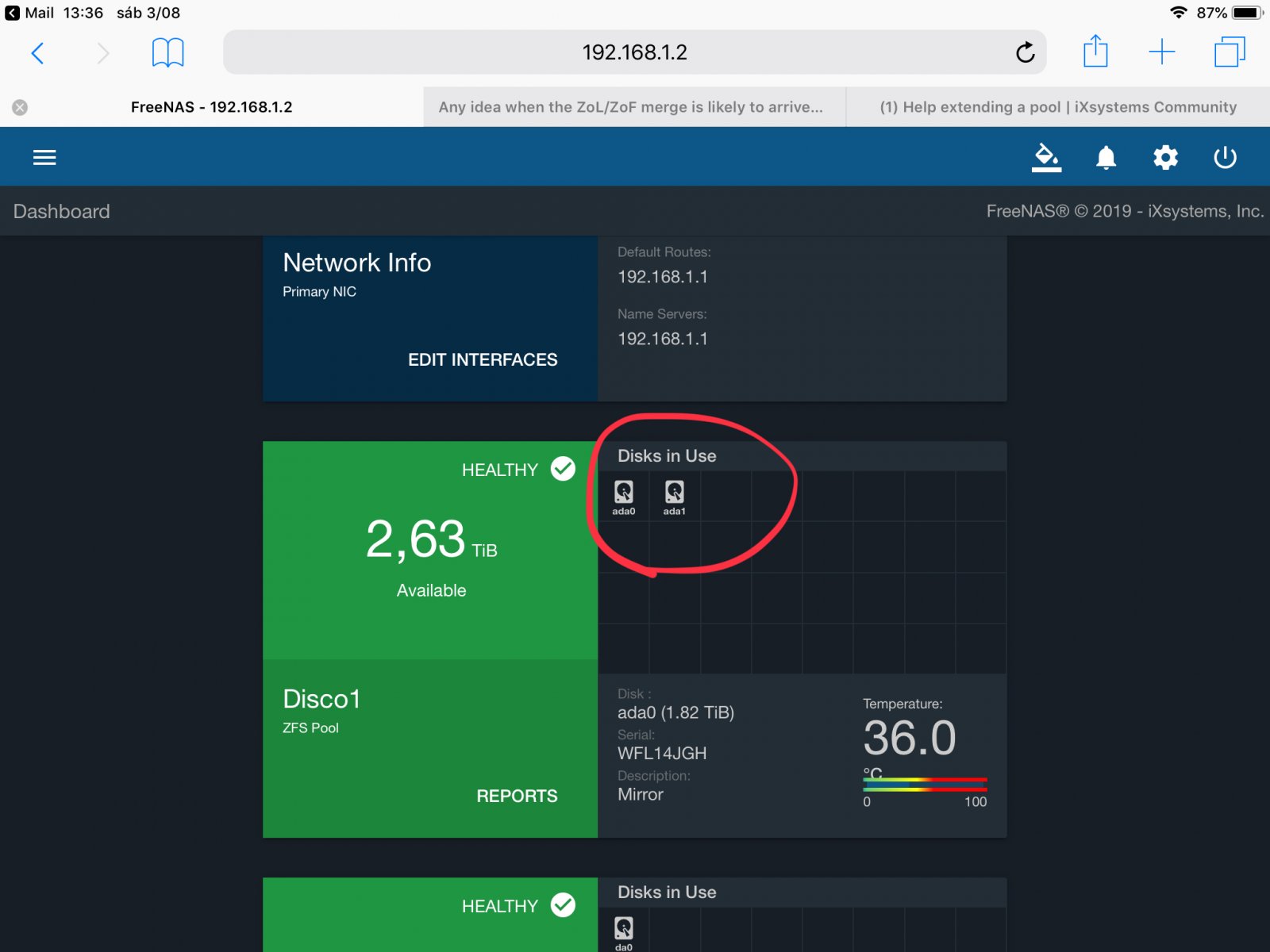

I need help because I added a new 2TB in my NAS. My intention is mirror my first disk. But I merged the pool accidently. So, now I have 4TB and just ‘one disk’. Can I revert this process to the original and had agiam two disks instead a merged disk? Thanks

15,504
You can, but you'll need to do it at the CLI. What's the output of zpool status?
Ok. It’s fine for me. My output is

15,504
So to remove the second disk, you'd run zpool remove Disco1 gptid/blah, where "blah" is the identifier of your second disk (which I can't copy/paste from a screen shot). Allow that to complete (which you can monitor with zpool status), and then you can remove the second disk. You can't add it to your pool as a mirror through the GUI--despite an outstanding feature request for over five years, the devs haven't bothered to add that feature. You can, however, do that through the GUI CLI; there are other threads here with instructions.

So to remove the second disk, you'd run zpool remove Disco1 gptid/blah, where "blah" is the identifier of your second disk (which I can't copy/paste from a screen shot). Allow that to complete (which you can monitor with zpool status), and then you can remove the second disk. You can't add it to your pool as a mirror through the GUI--despite an outstanding feature request for over five years, the devs haven't bothered to add that feature. You can, however, do that through the GUI; there are other threads here with instructions.
It works. Thank you so much. I will investigate a tutorial to implement the mirror in my second disk.
