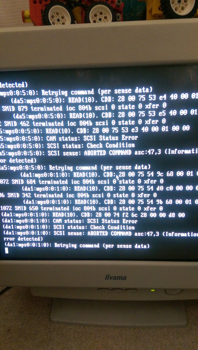

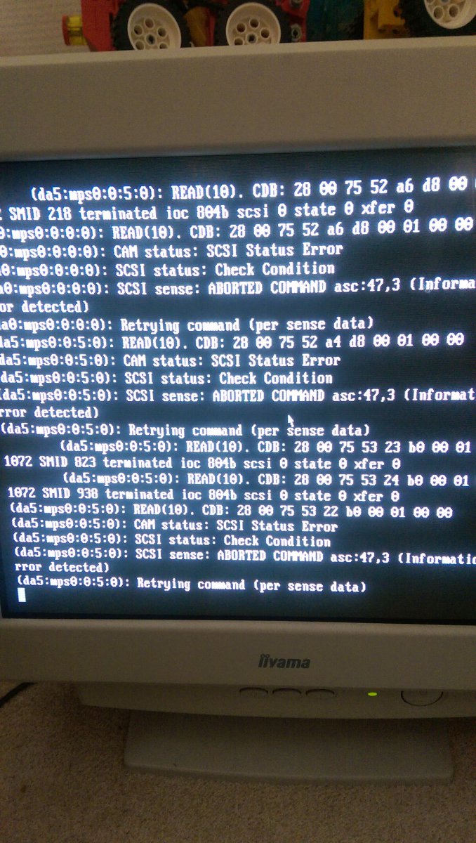

I have LSI 9211-8i HBA, with firmware P20, in IT mode. This firmware is the latest. The FreeNAS alert says: Firmware version 20 does not match driver version 16 for /dev/mps0, where mps0 is my HBA.
All the time when copying files, I can see this information on the screen attached to my NAS.
What is the problem? My data is still there, so no errors occur, but I just want to know what my NAS tries to tell me...

The FreeNAS alert is telling you that the hardware and software versions don't match. Downgrade the firmware to Phase 16.
You may run into problems if the versions don't match.

Thx for the reply.. I cant find P16 anywhere.... I can only go back to P19...

I couldnt find that archive part, but I did search on 9211 P16. I found the P16! My HBA is flashed back to P16.
Thx for all the help!

I have no alerts anymore in freenas!! I am happy!!!!!!! thx!!!!!!!!!!!!
D
Deleted member 37853
Guest
My NAS is even acting faster... It was hanging all the time because of the wrong firmware!
P20 firmware has been rather nasty, when it comes to interacting with the P16 driver.
