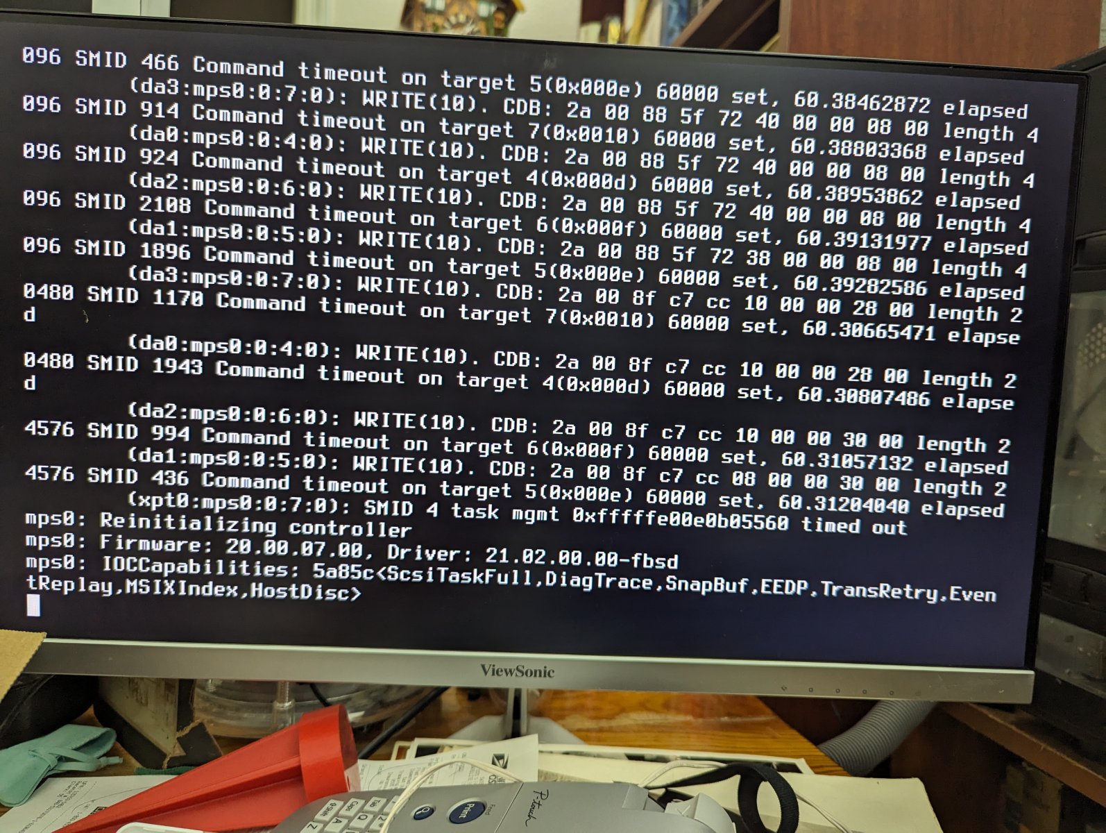

I've replaced my four Plex pook drives and the reboot issue is gone. I am now getting what looks like controller warnings: smid command timeout on target:
(perhaps the card was damaged by low voltage?)
The card I have now is a LSI 9207-8i RAID Controller Card 6Gbs SAS SATA PCI-E 3.0 HBA IT Mode Expander Card for ZFS FreeNAS unRAID (LSI 9207-8i RAID Controller Card 6Gbs SAS SATA PCI-E 3.0 HBA IT Mode Expander Card for ZFS FreeNAS unRAID https://a.co/d/4pB74Cy).
Any suggestions for a replacement (or is it a good card that's just failing?)

All clustered on targets 4 - 7? Or is it random? Bad cable? Bend stress, etc...? If it's clustered on a group of 4 addresses, it's likely the cable.

I'm not familiar with your hardware, case, backplane(s), etc... I saw "LSI controller" and assumed there was a breakout cable of some sort, ala: SFF-8087 to 4 x SATA, which would give a common point of failure for a set of 4 drives. Only you know your cabling, I was just suggesting things to inspect.
If the controller is failing it would likely be producing errors on all the drives connected it, not just a select grouping. The screenshot only showed a group of 4, which may not even be the case, I may have just inferred that incorrectly. Generally, the LSI controllers will throw a fault when they detect controller failures and the firmware halts until it gets a PCIe reset, but you'd need a debug cable to see it. You would only see the controller go missing abruptly, and if you have an advanced enough BIOS with some kind of LSI aware LOM, perhaps a bit more detail about a controller fault.

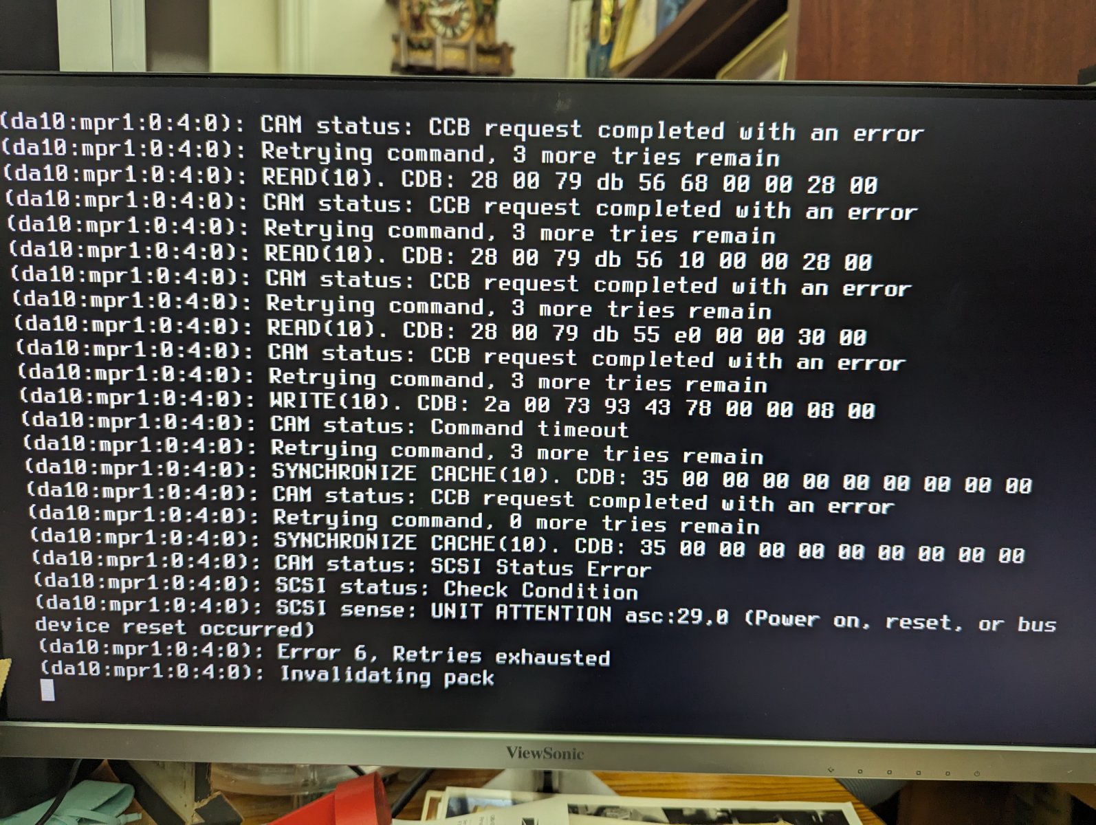

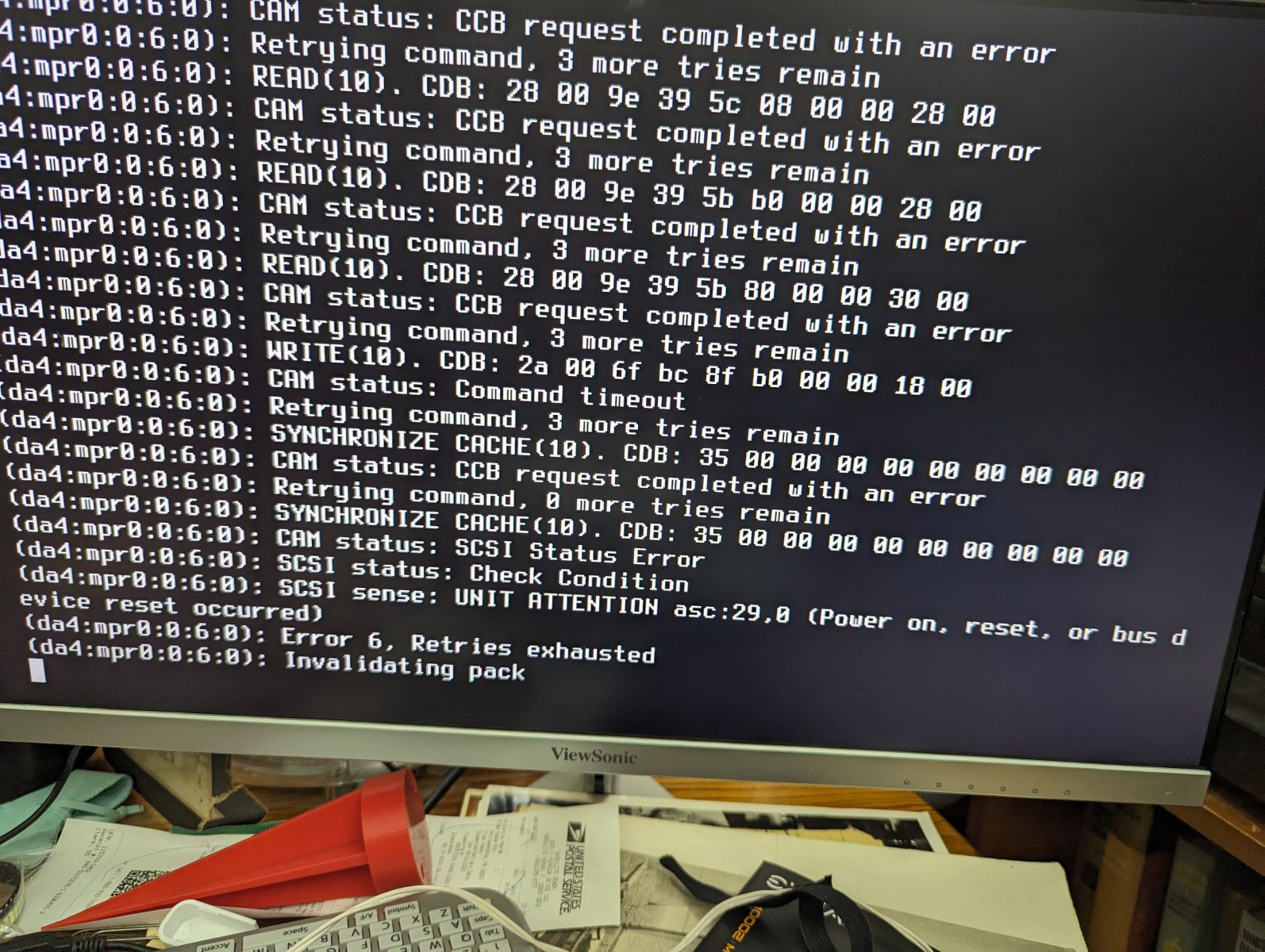

I saw this error on the console earlier today:
I looked up the error from the console and saw that it could be a loose cable or connector, so I moved the connectors around (to see if the error stayed on the same drive), plugged them back in (to reset the other end of the cables) , and rebooted.
Then I noticed this error (it could be that the pool was degraded earlier, but unfortunately I didn't look at the web page to see):
I ran the smart_report.sh script from FreeNAS-scripts-master and got this:

It ran overnight and I am getting the same errors:
I am really at a loss and any help would be most welcome
