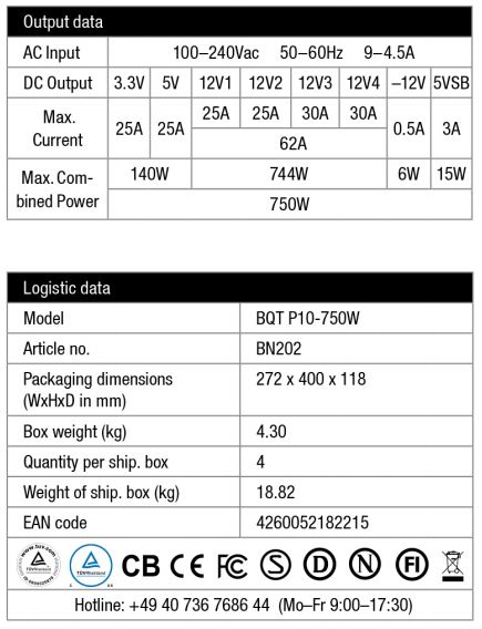

The zpool status you posted yesterday showed a resilver had recently finished, and since the drives showed 0 errors, I thought the pool would be able to recover. However, your status today shows top level checksum errors again, and failures of another drive. If you can shut down your system and re-balance the power load, maybe the pool can be restored. Removing the HBA may held your situation with the drives. If not, and if you have a good backup, I would say it looks time to give it up. There is no reason to let the resilver finish with those errors.
I think you need a larger wattage PSU, designed toward a large storage server. The important thing to look for is lots of individual drive power cables built-in. Each is designed to carry a certain power load without sagging. After all, it is a safety feature that too much power can't go through those small wires.

Right now, you just want to see if balancing the power and removing the HBA will get rid of the checksum errors. If they don't go away, abandon the pool. If you have hotswap bays, pulling the 8TB disks, and then plugging them in a couple seconds apart after turning on the system power might also help. (This means forget/cancel the SMART tests until the pool is abandoned, or healthy)
As for power supply, you will need to buy whatever power supply has enough rails, each rail rated for peak startup amperage of whatever number of drives you plan to attach to each rail. Your drives usually have the 5volt and 12volt amperages on the label. If not, 0.7 on 5volt and 0.5 on 12volt is reasonable approximation per disk, but I would specifically verify those 8tb disks.
As for your problem, I would assume it is power. Until power is eliminated as a cause, you will be chasing your tail on everything else. Nobody generally has that many independent problems, but power can cause all kinds of problems.

I have been waiting for the resilvering to finish, so the SMART Tests finish too. So I can post them, turn off the server and try redistribute the drives as even and fair as possible. Compared to building a PC with a powerfull videocard, that needs lots of powers, i never thought this could be an issue here. I mean, am not using a cheap or bad PSU, but I counted on 750W beeing enough.
What I didnt think of is how may drives are connected to one trail only (there is 5 trails and all are plugged in, but can not see clearly how distributed they are), add to that I have several fans connected to the same trail. I will look into that carefully once the machine is off, maybe I see too many drives and fans on one trail.
When I did the calculation once I built the sever, I came to conclusion that total Wattage was more than enough.
I don't know if it is not ?
Or if this is about some trails beeing overloaded (as I never before thought calculating on each trail :eek:). searching in the PSU manual to see if I find information about this

BE Quiet! Dark Power PRO BQT P10-750W

If there are any fans you don't need temporarily, you can disconnect those too. The power supply seems pretty decent. You could be pushing the limit or have a problem on the 5V though, considering there is only one 5V for the entire system. The 12V looks very good, as long as the load is balanced.
If the pool doesn't recover, you can create a new one, and continue to do testing on the hardware. Switch everything over to the HBA, complete all the SMART tests, and see what happens with some test data on it.
May 10, 2017
838
You shroud really avoid a multi-rail power supply for storage servers, depending on how the rails are distributed you may not have enough 12V amps, e.g., this is a typical 4 rail power supply:
12v1 is CPU
12v2 peripherals
12v3 and 12v4 GPUs
Leaving you with 25 Amps for all the disks.
15,504
Two amps per disk on 12v for startup would be a better planning number.

Ok, I saw some reviews and it's a pretty good PSU. Unless it's old or there is a defect of some sort it should not be the PSU. The thing is, unless you can test with another PSU and/or you can do some measurements with an oscilloscope then you can not be sure it's not the PSU.
I agree with @danb35 I've made the measurements myself, 3 A total for both 5 and 12 V for a few seconds is common for the drives used in our NAS, the details are in this thread if you want more :)

And of course I agree too, in order to troubleshoot a power supply problem you really need another power supply or some test equipment. Trust me, a new power supply is cheaper. And we here like Seasonic. You don't need a Gold or Platnum power supply, a Bronze rated one is good too. Look for a sale and buy one. Right now I'm not thinking it's your power supply, likely your HBA, but one never knows until you prove it. So if your hard drives are doing what is expected and the pool recovers and operates fine and looks proper, then I'd move that pool to the HBA connectors and use it for a while, testing it out to ensure it works fine. I suspect it will start throwing errors again.
If you need access to your "Main" pool, you can connect it to the motherboard SATA connectors again but it doesn't help the troubleshooting efforts at all right now. If you have another computer that has 8GB RAM, you could use that to host your main pool, but I don't know if you have one.
12v1 is CPU
12v2 peripherals
12v3 and 12v4 GPUs
I read a bit about that, it seems some people prefer one-rail PSU while others prefer multirail PSU.
If you would recommend a one-rail PSU, what would that be ? :)
That thread is way to advanced for me, but I can see the you love the topic :)
Sure the PSU is one of the best out there, at least when I bought it, read many reviews before getting it.
Not sure if I followed you with "3 A total for both 5 and 12 V for a few seconds is common for the drives used in our NAS". But do you think too many harddrives and some fans on one PSU trail could be a problem and causing this ?
