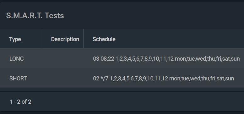

Smart tests set up as follows:

I thought it was interesting that the most recent smart tests reported were about 7000 hours ago for both drives. Compare "power on hours" with the hours for the most recent self-tests.
Did you turn off SMART or not enable it for those specific drives?
trey22
Apr 11, 2013
28
As far as I know, SMART was setup when drives were installed years ago and I've never made a change to the settings.
9,700
Effectively you've been very slowly scanning the drives by reading and writing to them, so the fact you didn't catch those bad sectors sooner is all you lost.
Redcoat
Feb 18, 2014
2,925
Something to look into then - that the service is turned on and also the Enable SMART box is checked for each drive in Storage>Disks>Edit Disk - I missed this last step after a disk replacement ...
trey22
Apr 11, 2013
28
Yeah, service is turned on. Checked for each drive. Each disk shows Enable SMART: True. SMART extra options: N/A.
Redcoat
Feb 18, 2014
2,925
Just another of life's mysteries...
