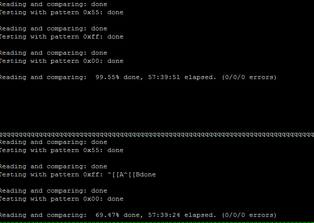

I've been running badblocks on a pair of identical new drives, started within seconds of each other. Somehow, the one fell out of sync with the other between the second and fourth passes and now I have drive A virtually done after around 60 hours of testing (0 errors) while the other is still only at around 70%. Should I be worried?
Not really. That's fairly typical. The long test time tends to highlight performance differences.
