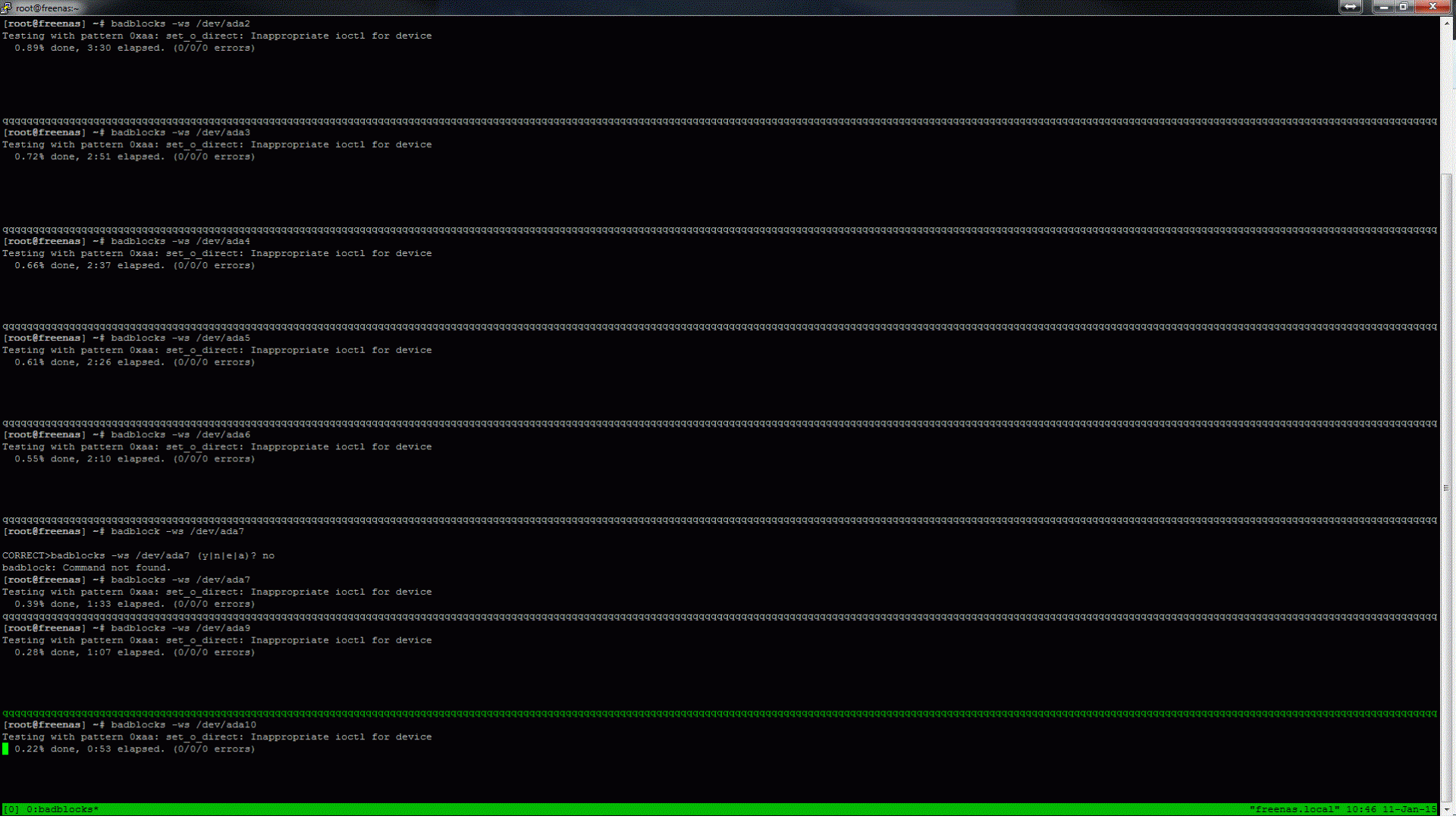

Matdif
Oct 10, 2014
59
I have a problem with the badblocks test and was wonder if someone could interpret it.
A month ago I had a problem with a motherboard I was using to set up freenas. Specifically the motherboard is the
C2750D4I found in the recommended hardware thread. The specific problem I had was that the bottom 4 sata ports on the marvell controller could become unreliable when loaded with more then 1 hard drive. I found another person who had the problem and after he got an rma he says he still had it. Meanwhile I had sent my board in for replacement and told Asrock over the phone my specific problem. Meanwhile it took a month to get a board to me with ups losing it finding it sending it back to them plus the holidays.
Now I have a board back but it looks like an updated model. At least they changed the packaging from a black box to blue and such. The board itself looks much the same but I was hopefull they upgraded something or fixed the problem. Now I hooked everything back up made sure to fill every Marvell sata port as a test and started a badblocks test again on all slots.
The problem is I am getting an error I did not get before.
I just started the tests and every hard drive badblocks test immediately gave me back "set_o_direct: Inappropriate ioctl for device". The first board I had did not give this error I still have a screenshot from before.
You can see it in the pic. The tests seem to be continuing so I will wait and see if I get any error emails for the marvell controller becoming unreliable unstable like before. In the meantime I was wondering what everyone thinks of this error. Is the test still good? Or has something changed in the board that will make the test unreliable? Is there something else I should do now to test and make sure this thing will handle a zpool well?

Not really. Any errors are immediately logged. A bad sector won't be found until it's read/written, but it'll be found during normal IO and not just tests. The short test does... something... at least we think it does. The long test is supposed to do a full surface scan. The conveyance test is only meant to be used after transport.
Failing SMART errors tends to indicate a bad drive.
