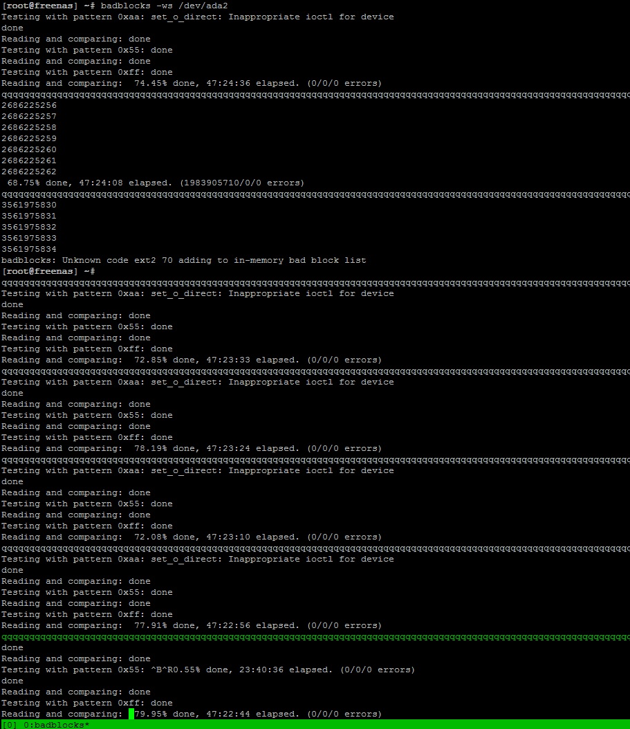

I have a problem with the badblocks test and was wonder if someone could interpret it.
A month ago I had a problem with a motherboard I was using to set up freenas. Specifically the motherboard is the
C2750D4I found in the recommended hardware thread. The specific problem I had was that the bottom 4 sata ports on the marvell controller could become unreliable when loaded with more then 1 hard drive. I found another person who had the problem and after he got an rma he says he still had it. Meanwhile I had sent my board in for replacement and told Asrock over the phone my specific problem. Meanwhile it took a month to get a board to me with ups losing it finding it sending it back to them plus the holidays.
Now I have a board back but it looks like an updated model. At least they changed the packaging from a black box to blue and such. The board itself looks much the same but I was hopefull they upgraded something or fixed the problem. Now I hooked everything back up made sure to fill every Marvell sata port as a test and started a badblocks test again on all slots.
The problem is I am getting an error I did not get before.
I just started the tests and every hard drive badblocks test immediately gave me back "set_o_direct: Inappropriate ioctl for device". The first board I had did not give this error I still have a screenshot from before.
You can see it in the pic. The tests seem to be continuing so I will wait and see if I get any error emails for the marvell controller becoming unreliable unstable like before. In the meantime I was wondering what everyone thinks of this error. Is the test still good? Or has something changed in the board that will make the test unreliable? Is there something else I should do now to test and make sure this thing will handle a zpool well?
Did you perform this step?
http://www.asrockrack.com/support/ipmi.asp#Marvell9230
(Disabling Marvell SE 9230 HW Raid)

Havent done either yet. If I can figure out how ill run your test. Badblocks has started doing something new and unusual see the screenshot.

Haven't done either yet. If I can figure out how I'll run your test. Badblocks has started doing something new and unusual see the screenshot.
You have to disable Marvell SE 9230 HW Raid ! ! !

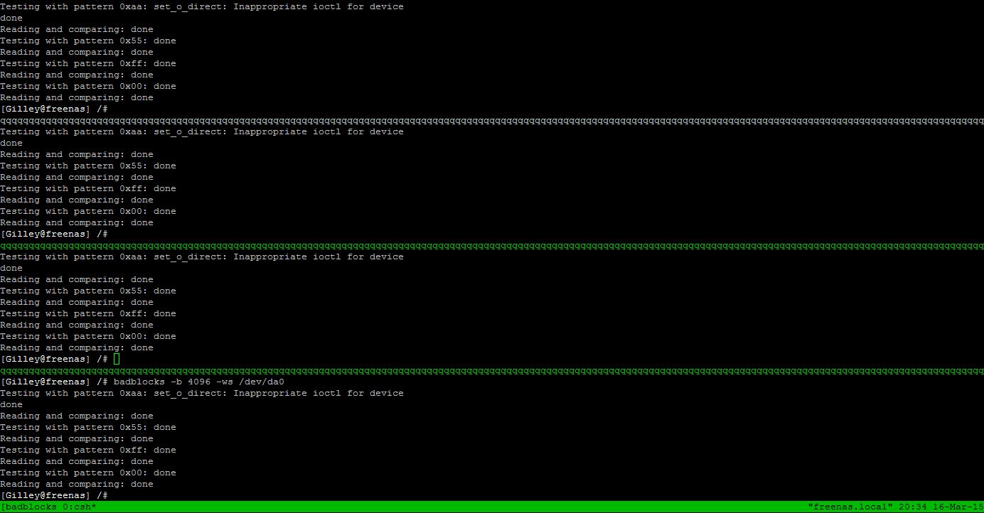

This was also asked earlier and I didn't see it addressed so just figured I would bring it up again, upon initializing the badblocks test I get this message reported:
Testing with pattern 0xaa: set_o_direct: Inappropriate ioctl for device
As a new user, and shame on me for not reading all the way to the bottom of the thread before running the test, it would be nice to move some of these improvements such as the -b 4096 option into the main guide.

It's early (I have no idea why I am awake) and I was just looking at the progress of my badblocks test and noticed this steady write performance decrease on the Red's from the 140-150 to 70-80 as well at the end of the write cycle. I was just trying to reason my way through this as to why this occurs. I like to ask questions, so I will. What is the technical reason for this? I have an idea, but I wasn't able to confirm with some quick googling, so I figured I would just ask the experts. :)
The Seagates are rated at a Max Sustained Data Rate of 180MBps whereas the Western Digitals are 147MBps so that the Segates are faster is within the specifications. I suspect the variation in speed is due to the tracks on the HDD getting smaller as the heads move into the platter and having to do more seeking for the same datasize. I believe Eric Lowe mentioned this in a previous reply in this post.
Also I noted that the Seagate disks really sucked at some tests (5 concurrent reads) taking 5 times longer that the Western Digitals.
Normal behavior see this post[/QUOTE]

Just to make sure I understand. I had been monitoring the tests as they ran. I saw no errors reported. At the end of the test I would have expected something saying "Passed no errors reported." This is what I got though. Does it truly not give a summary of the test?

No news is good news. If there were errors it would list them to standard output (and possibly standard error).
After running Badblocks you might want to rerun the long smart tests now that the disks have had a bit of a work-out
