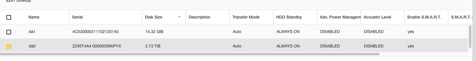

I'm just setting up my FreeNAS server, I've had a little test system working with three SATA disks to kick the tyres and check how things work.
Since then I've got a H310 SAS card and reflashed it to work in IT-Mode, (or at least I think I have, no errors reported) I've got 6 x 3TB SAS Seagate Constellations and am now rebuilding the FreeNAS server.
After crossflashing the 310 card and installing the first of my SAS disks, I've restarted the server to check that the first disk can be seen and 'looks' OK.
I then realised that I have no real idea what success is, I think this looks correct but to be honest I don't know.
I checked the disk using FreeNAS and got the following. Does this mean that the H310 is in IT-Mode and the disk is being presented to FreeNAS correctly. It looks like it to me but I simply don't know.
Is this what is expected? Is there any test to check the H310 is working in IT-MODE or is the above confirmation?

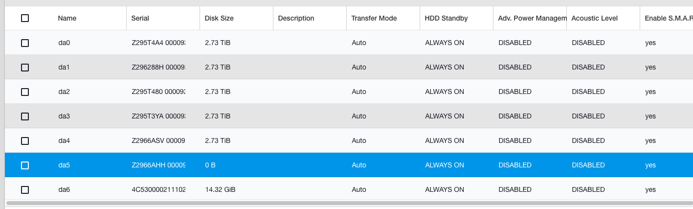

I downloaded a copy of MPTSAS2.ROM from the LSI site you provided and upgraded the H310 card so it now boots with BIOS config settings. It adds about 20 secs so it's nothing in the grand scheme of things.
I did check that the H310 card was setup in IT mode it and it was. So thats nice :)
I now need to get the burn in on the disks done.
Thank you for all the help,
Rob
