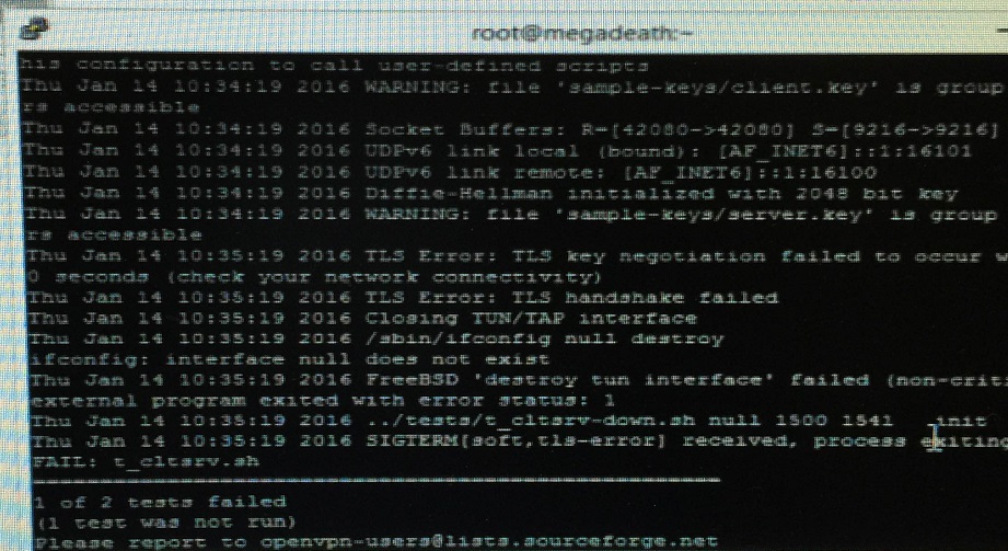

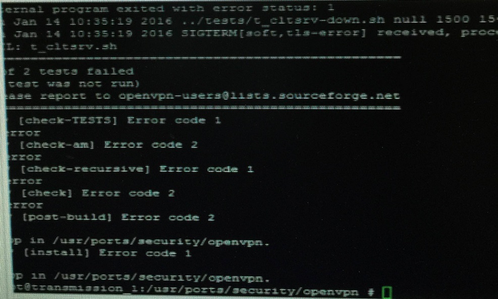

Thanks for replying, I have not tried any thing since my last post as not sure how to start over..
I think I have an issue on step 10 where you do a clean install of open vpn..i have errors
  1. ##Step 10: Make a clean install which allows us to set the option of a password file.
  2. root@transmission_1:/usr/ports/security/openvpn # make install clean
I have attached a couple of photo's that dictate errors..hopefully someone see's what I am doing wrong..
Thanks for all the help much appreciated

I can't see the whole width there and not sure of the context. Can you just copy and paste the text from your terminal? Anyway, clearly openvpn installation is failing. There's something there about reporting it to the openvpn user list - I would try that.
If worse comes to worst you could just start over with a new jail and follow steps carefully. I bet that would work.
