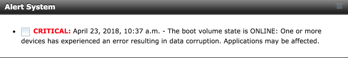

I am still getting the attached message after loading a fresh install. I am guessing this shouldn't be something over looked?
Maybe I should pick up 2 new 120gb SSDs?

Sorry, I saw that the boot drives were SanDisk and didn't think about them making SSDs now. That looks to be a good build and with the boot drives being SSDs I wouldn't have expected the problem you had. Are the boot drives connected to the system board SATA ports? What are the BIOS settings (AHCI) for those ports? I know that my system board had some fake-RAID functionality in the SATA controller that I had to disable before it would work properly.

The boot drives are connected to the motherboard. I will have to check the BIOS on those ports, I haven't changed much in the BIOS settings for this build yet.

Ok just looked the ports are AHCI..
Maybe I should try one boot drive at a time, see if one of them is bad?

I got the SSDs working singularly. Am I doing something wrong when selecting both drives on installation for a mirrored set up?

Supposedly SSDs are more reliable for boot drives. I had two SSDs, running into a mirroring issue of some sort.
