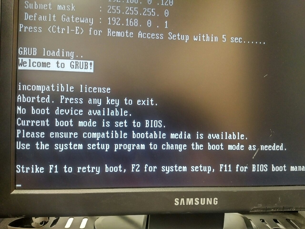

Been running 9.10 on 2 Dell R610's and on a hand built Xeon/mini ITX board units with no issues until now.
Updated all of them to FreeNAS-9.10.2-U2 (e1497f2) and one of the Dells comes up with Welcome to Grub! Incompatible License. Press any key... No OS found....

Can you get us some screen captures?
Aug 23, 2016
14
Screenshot below. When I tried to clone the boot partition on the flash drive I got a cyclic redundancy error. This may be a bad flash drive instead of an update issue. The data partition seems fine so I'm going to copy a good version of a boot partition to a clone of the original flash drive. More as it comes.
Don't. Make a fresh install of FreeNAS to new media and import your config. Definitely sounds like a borked boot device.

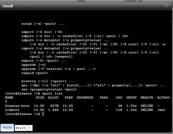

Aug 23, 2016
14
Not having any luck mounting the old flash drive. I ran zpool import -f -R /mnt 16818708022404241471 oldboot and this is what I get.
What now?

Looks mounted to me...

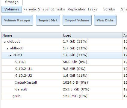

Aug 23, 2016
14
I was able to get this far. See image.
I can access anything in the grub folder but nothing off ROOT. I can't even change the permission on ROOT.

Drop to a shell and cp the file to a share. Or use SFTP to grab it directly.
Aug 23, 2016
14
Yeah, I think this is where this dies. The problem is I can't set the permissions on the ROOT dataset, the user and group come up blank. I can change it to root/wheel and set read/write/exe attributes and it says it accepts it but it doesn't stick. I can't make it a share or access it via shell, ssh, telnet, direct console, etc. I can see /mnt/oldboot/grub and anything inside ./grub and that is it. It's like the update process removed permission/locked that dataset for the updates to apply but never got there finish up the job.
