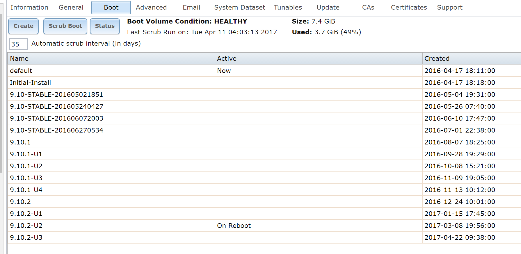

I just tried to upgrade to 9.10.2-U3 - and changed after that the boot environment to 9.10.2-U3.
Probably something has not updated correctly, but I cannot boot any longer. Grub will start in the rescue mode with
"i386-pc not found".
I have a raid 1 installed on the USB Boot drived and am not able to do anything (cannot read/write to grub.cfg because of the Raid Volume...)
Would be very thankful if someone can help me out of that issue and help me how to boot the old 9.10.2-U2 configuration.

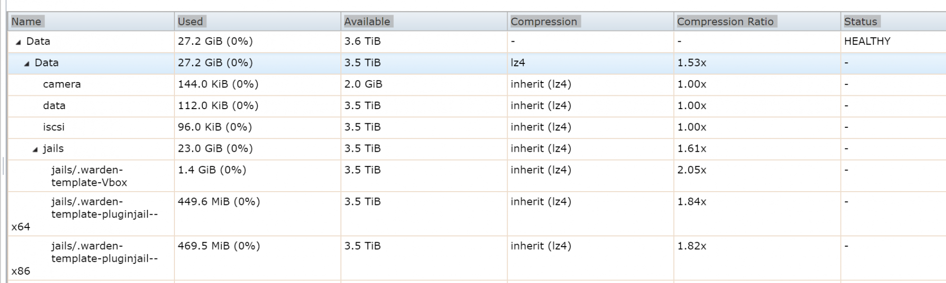

No I have checked on my issue a little bit deeper and I am getting worried that my data might be lost (which I do not understand because it is on another array)
As I cannot boot from by USB raid devices, I have installed new (3rd) USB stick with a fresh FreeNAS installation. After booting it seems to have access to my 2 'faulty' usb devices and from the GUI everything looks ok - so /boot is healthy and my Data Pool seems healthy... but all data from the Data pool seems to be deleted...
Once I take out the 3rd USB stick I still cannot boot.... the most important part for me is the data I have stored and access to the jails which I had created... nothing is available right now... any ideas/tips ?

So for me the Data/Data/data part is the critical one which is shown now as empty...

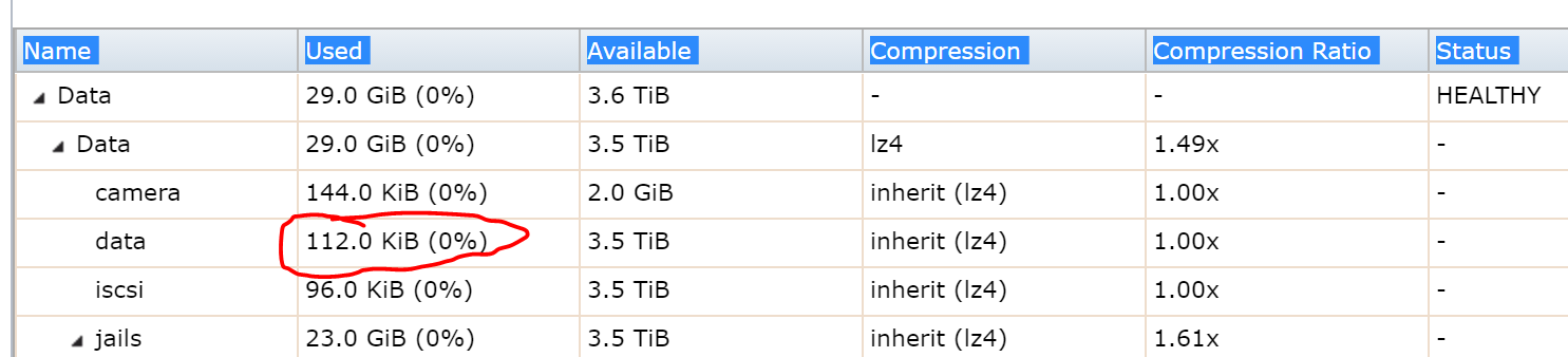

How do you figure?
Because I can access the drive but is is empty - and in the volumes I can see that no data in in there (see attachment). I have not done anything with the array after the crash... (like import etc.)
Hardware - I have 2 USB drives with Raid 1 for /Boot and 2 NAS HDD (Raid 1 ) for the Data.
