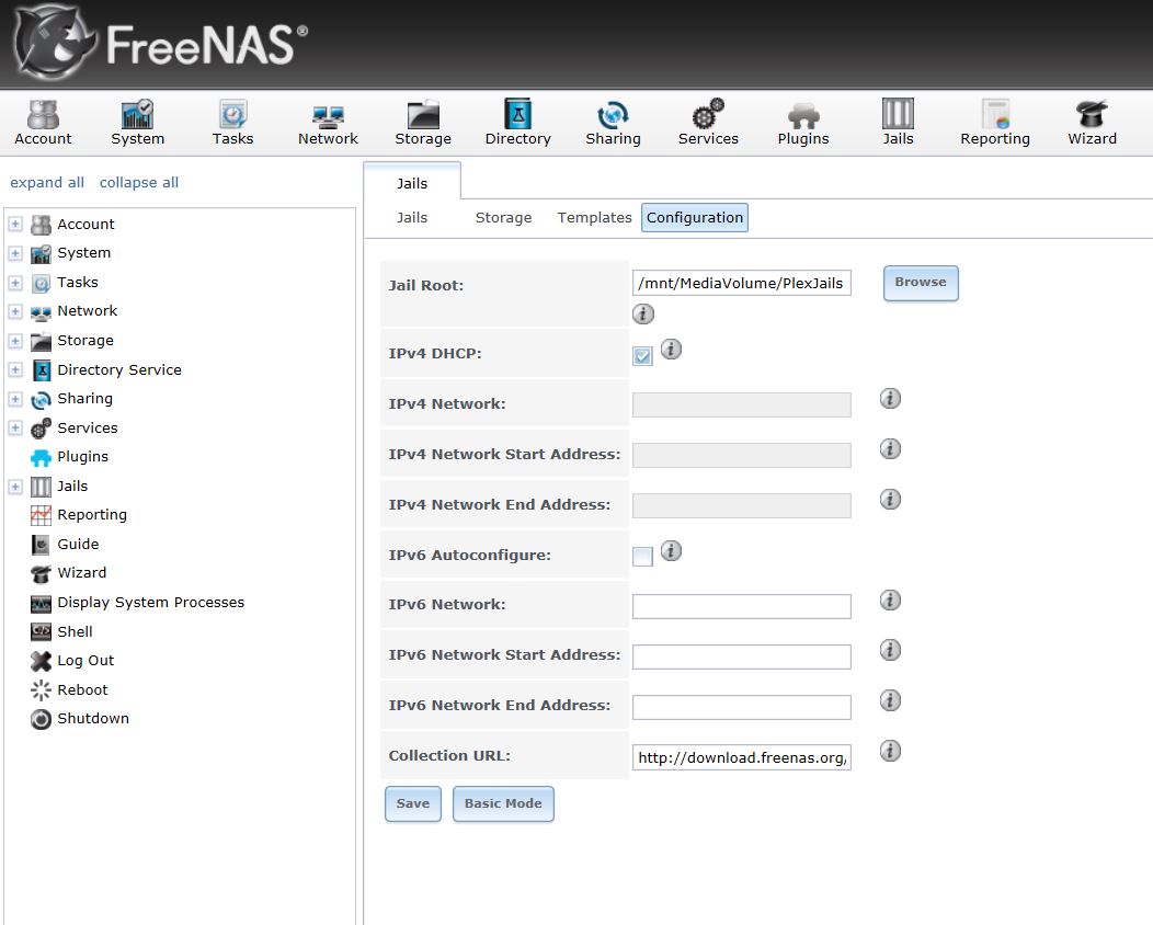

If this is helpful, I went to Jails/Configuration/Advanced Mode;
IPv4 Network: 192.168.86.0/24
IPv4 Network Start Address: 192.168.86.20
IPv4 Network End Address: 192.168.86.250
So, we're a little off here.
This range is for the jail dynamic IP space. If you want to run the equivalent of a DHCP server specifically for your jails, this is what you set here. You also need to make sure that these settings do not overlap with your router DHCP server, which is the problem we're seeing here. You need to clear these settings. I would suggest that you simply check the "IPv4 DHCP" setting so your jails will use your network's DHCP server.

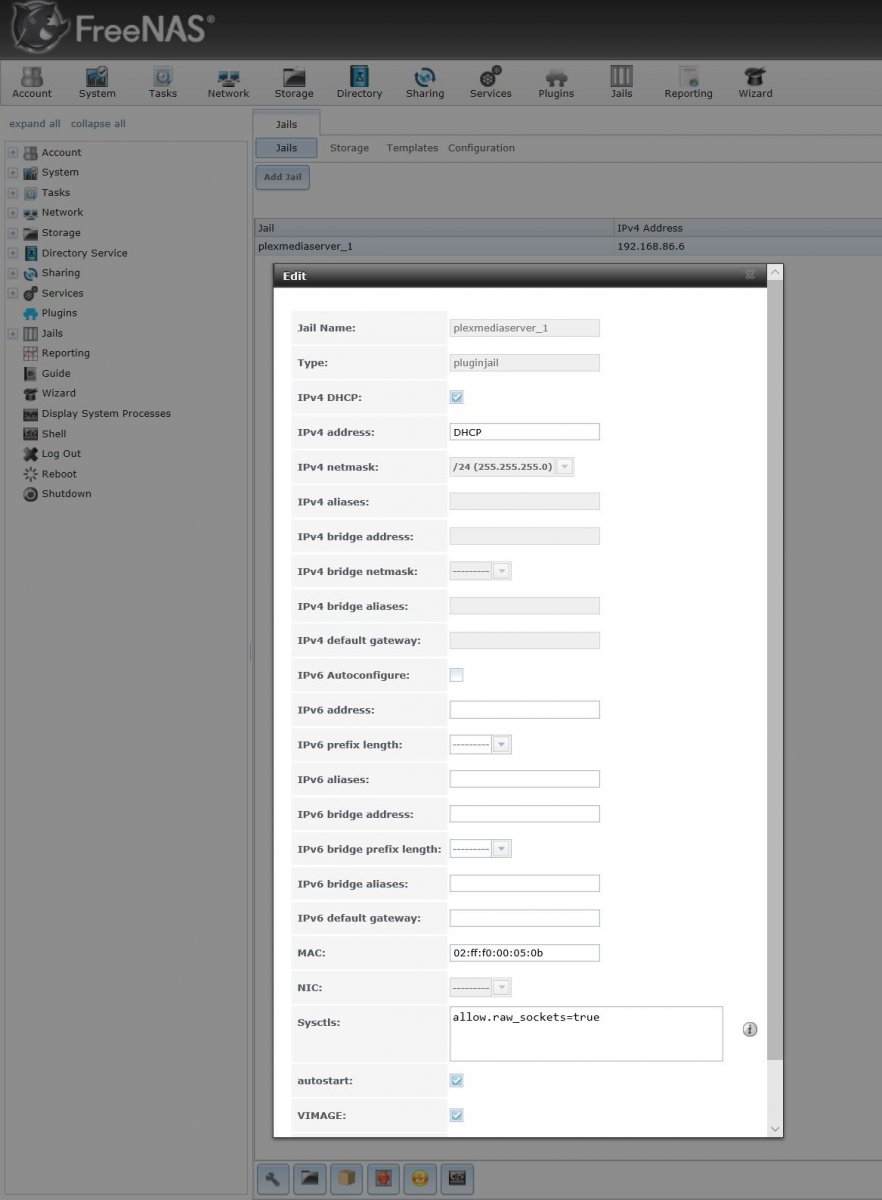

I went to Jails/Edit/Advanced Mode and changed IPv4 address: from 192.168.1.7 to 192.168.86.6.
Can you post a screenshot of the advanced configuration for this jail?

I wasn't sure exactly what advance configuration you were referring to so I sent to screen shots.

From your second screenshot, it looks like your Plex jail is configured for DHCP. You'll want to change that to be a static IP.

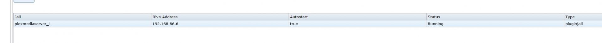

I unchecked IPv4 which allowed me to input an IP address into "IPv4 address:". I entered 192.168.86.6. When I go back into Jails/PlexJail/Edit, it still shows as DHCP. With that said, the plex jail does show the corrected IP address.

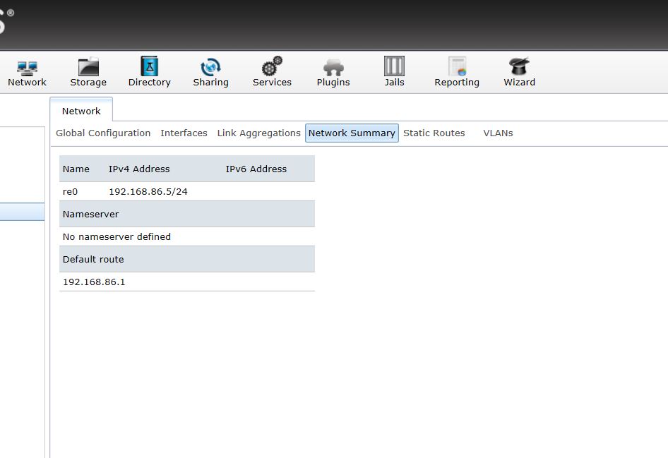

within Freenas, it says "no name server defined"
You need to enter your ipv4 default gateway address in the Network -> global configuration tab. It should be the LAN address of your router. That is also what you need to add to your jails /etc/rc.conf file.

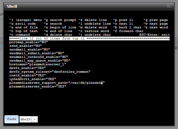

After you've set your ipv4 default gateway in the GUI go to your jails tab. Highlight your plex jail by lciking on it and open the shell using the shell icon at the bottom of the page. Once it's open type ee /etc/rc.conf and it will open the file in question. Use the arrow keys to navigate down to the nameserver entry and change that address to your default gateway. Once you've done that hit the Esc key and save your changes.

Crap, what was I thinking. ee /etc/resolv.conf
Sorry about that. :oops:
Fernando Zoota
May 11, 2015
29
that worked. don't worry about the mistake. If i had a nickle for everyone I made, i'd be sailing on my yacht ; )
