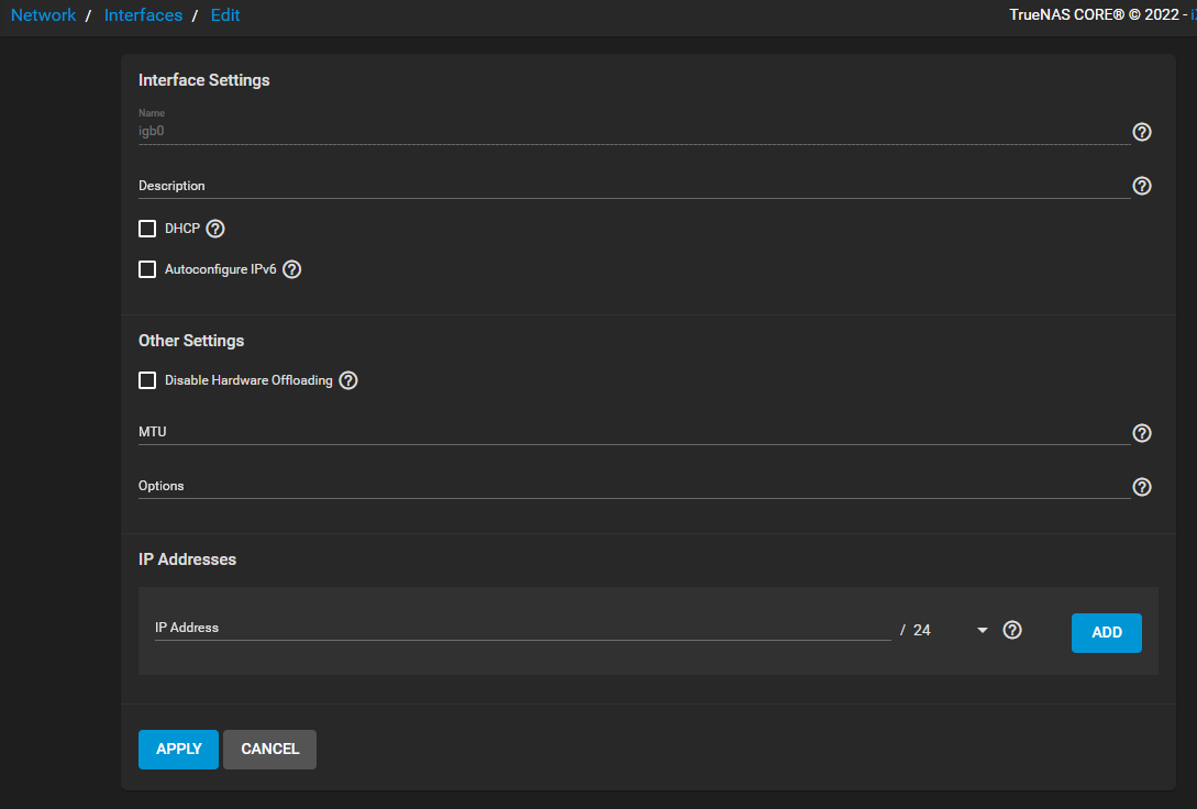

What settings do you have setup for the igb0 interface here: Network/Interfaces/igb0/edit:

Bad assumption. Your TrueNAS interface can be setup for static or dynamic... in TrueNAS. If you use DHCP, and you've reserved an address in the router for TrueNAS, the router should just assign the address you've reserved. If you setup a static IP in the interface settings in TrueNAS, it will not ask the router for an IP address, it will just use the one you configured in the interface settings on TrueNAS. This can create a lot of issues for you with the router's DHCP server. Especially if you've configured an IP address in TrueNAS, and then that IP address is handed out to another device on your network by the router.
My suggestions/advice:
  1. Based on your knowledge of networking, you should be using DHCP. It is easy... it just works without you needing to manually set IP settings on your servers and other machines.
  2. If you want TrueNAS to use a static (or consistently assigned) IP, use your DHCP server to manage that. It will keep you out of trouble. The TN interface will ask your router for an IP, and the DHCP server will assign the one you've reserved... AND it has the added benefit of telling the TN server what the default gateway and DNS server addresses are.... i.e., ensuring the TN can talk to the internet.
  3. If you want to set the address as a static IP in the TN interface (which I do not recommend for you), you MUST assign an address outside of the DHCP server's pool of addresses (that setting is in your router's DHCP settings), but still within the same subnet (e.g., 192.168.1.X), and you also must manually enter the default GW and DNS addresses, which in your case are both 192.168.1.254, in the TN network global configuration page.
Your posts indicate that you do not firmly grasp the idea of subnets and IP addressing. You should do some reading if you want to manually manage your LAN IP assignments... otherwise, use DHCP and the router's DHCP reservation settings for those servers where you want them to be assigned a consistent IP address.
Yes I don't fully understand a lot of the networking side of things lol. My interface settings look almost the same except I have a description set to "em1" and the IP Address field shows "192.168.1.115"
