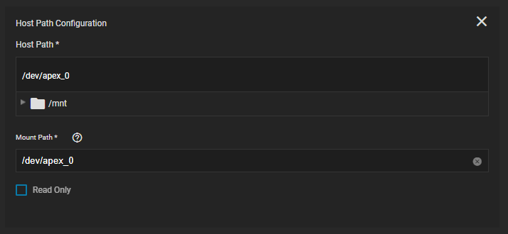

How do you passthrough the TPU to Frigate?
I managed to install drivers for the TPU on my TrueNAS Box:
root@truenas[~]# lsmod | grep apex
apex                   24576  0
gasket                114688  1 apex
root@truenas[~]# lspci |grep -i tpu
05:00.0 System peripheral: Global Unichip Corp. Coral Edge TPU
root@truenas[~]# ll /dev/apex*
crw-rw---- 1 root 120, 0 Mar  7 17:22 /dev/apex_0
I shared this device with my Frigate Docker-Container and configured Frigate to use the TPU:
detectors:
  coral0:
    type: edgetpu
    device: pci:0
  coral1:
    type: edgetpu
    device: pci:1
But Frigate complains that no TPU was found:
[2022-03-07 19:29:55] frigate.edgetpu                ERROR   : No EdgeTPU was detected. If you do not have a Coral device yet, you must configure CPU detectors.
zatarc
Mar 7, 2022
4
@zatarc Did you manage to get it to work? I'm about to the same setup soon. :)
Yes, indeed (and I'm sorry for not sharing this information).
When you run a container in "Privileged Mode", ALL devices will be passed to the container. Frigate is then able to access the TPU.
But I don't know if this is the best solution. I would feel more secure if I could only pass this specific Device to Frigate.

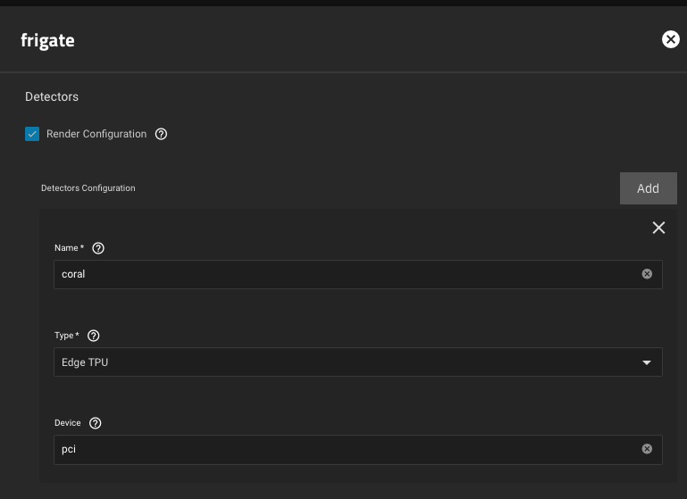

If you want to go via the Truechart route, just select the "Render Configuration" checkbox right after the MQTT options in the chart configuration, click on "Add", and fill a name (can be anything I suppose), choose "Edge TPU" as the Type, and type "pci" in the Device.
If you have several coral boards, choose one for each detector:
detectors:
coral1:
type: edgetpu
device: pci:0
coral2:
type: edgetpu
device: pci:1
Or mix usb and pci:
detectors:
coral_usb:
type: edgetpu
device: usb
coral_pci:
type: edgetpu
device: pci

I have a similar setup with a dual TPU card; my backordered TPUs just arrived. I've installed it and run the steps from @j0rd's script, after chmod on apt. I see what I assume to be two TPUs in the output of `lspci |grep -i tpu` and `ll /dev/apex*`.
Can I use the Incubator Truechart for Frigate with this? This is the first time I've ever run TrueNAS SCALE and the second time I've ever tried to install Frigate. (Never finished the first one.)
I just setup the incubator chart - see my post above. Works fine, inference dropped to 1/10th of when using CPU.
