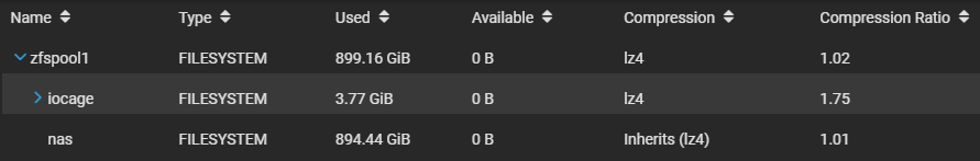

Hello, I am the point where I can't access my drive because it's 100% full by the backup manager (Iperius Backup) hasn't probably been setup properly by myself.
So, luckily this is just my home lab and data is not important at this point and I can erase everything. But I want a lesson to be learnt and also if this would be kinda production situation what would I do? Basically, are my files still there and can I access it somehow?
Also, in this particular situation, since the date is not important, how do I just simply format the drive and keeping all the settings? Basically erasing data on it. Thanks.

Your data is still there, but because ZFS is copy-on-write any operation, including deleting files to free space, would require free space to register additional metadata.
You can solve the issue by attaching a new vdev to get free space. If this is a mirror pool the problem is solved; space permitting, you'd even be able to remove a vdev later to return to the original layout, with larger drives and/or with some data deleted to free space. If this is raidz pool, you're stuck with the additional vdev forever.

So I went to shell and used commands:
zfs list
cd "path to my nas drive"
ls
rm -r "folder name I wanted to remove"
Then simply rebooted device and voila I got freed up my space and have my drive accessible again. Thanks!
