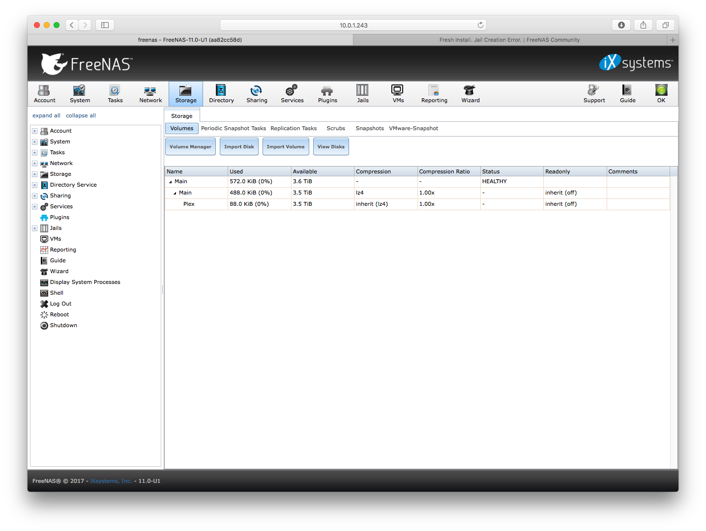

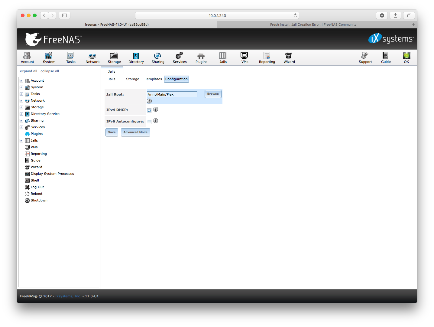

Where should I look to set that? I have under configuration a jail root set. I have tried adding a sub dataset in "Main" and am still getting an error.
Screen Shot 2017-07-11 at 10.47.53 PM.png Screen Shot 2017-07-11 at 10.48.08 PM.png

You may want to change your jail root, as I'm assuming you're trying to setup a jail for Plex? If you leave everything as currently configured, all warden jails and files will be saved in /mnt/main/Plex. Try creating a dataset named "jails" under /mnt/main, changing the Jail Root to /mnt/main/jails, however I'm not sure if that will make any bit of difference. If not, someone more experienced than I will need to reply.

That's how I had it setup prior and added a sub dataset to see if that was part of the issue.

Log in via SSH and issue ls -lsa /mnt/main/Plex
  • If there's not a .warden directory, try clicking save on the Jail configuration tab, else see if a reboot solves it. The issue appears to be your Jail Root isn't initialized (i.e. hasn't been setup if it's lacking the .warden and templates directories).
Also, FN 11 has been released, which is recommended to upgrade to. Also verify the correct jail templates are available (Jails: FN11 , FN9.10)
